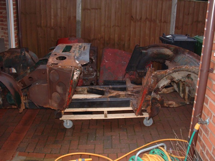

Lance,
For rolling the chassis around I borrowed a great pair of dollies that were originally used in hospitals. Perhaps a hospital surplus supply?
https://www.loftusdesign.net/dolly_lores.jpg
For a 'poor mans' rotissery, I built one out of wood. I considered buying engine stands, metal channels and welding one up but it would have been overkill for the small amount of work that my frame needed. This allowed me (takes two actually) to turn the chassis on each side to get to the work area. It cost about $40 in materials and is now being used for the prep and paint process.
https://www.loftusdesign.net/woodstand.jpg
Cheers,
John
Wow! What a great resource you all are! I have to admit that I was thinking of something similar to John's hospital dollies, but for an inexpensive way to go, I kinda like the wood rotisserie as well. Thanks, all.
