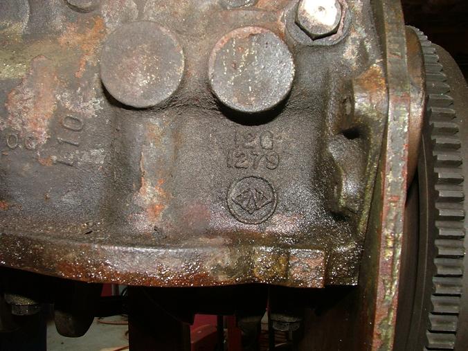

I assumed the '60 Bugeye I have was the original 948 engine. Now, I saw a plate on the bottom left side that says 1275. At risk of sounding completely foolish, what else can I look at to confirm this?
Should have a number cast into the block, raised, just aft of the waterpump on the port side.
I had a 1275 on the stand so I took a picture. This is on the left side block (oil pan is off).

The easiest way to differentiate a 948 from a 1275 would be whether there are removable side covers on the left side of the block. 948s had 'em, 1275s didn't!!

I believe you'll also find that the heater take-off on the cylinder head is angled at 45 degrees to the rocker-shaft on the 1275 engines. While you can put a 1275 cylinder head on a small bore block, it typically requires pocketing the block to do so.
