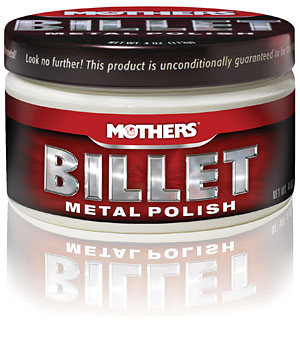

Hi Mike,
To clean it, I use De-Solv-it Contractors' Solvent. (Better than Goo-gone)
Then I use Mothers Billet Metal Polish.
Cheers,
Roger

+ 1 for the Billet
Maybe use a Mothers polishing cone instead of musclepower ;-)
Hans

The problem with (products like) Billet, is than when you "polish" aluminum, you always get a (BLACK) residue and you'll leave it within the surface reliefs (texture) of anything but smooth aluminum.

Randy Forbes said:
... The problem with (products like) Billet, is than when you "polish" aluminum, you always get a (BLACK) residue ...
That's right, but (IMO) only because polishing is one of the steps tot take.
After the Billet clean with a degreaser and protect with a sealant. Mothers has both in the program.
Sealants like Chemical Guys JetSeal contain cleaners so they combine the two steps
Hans
