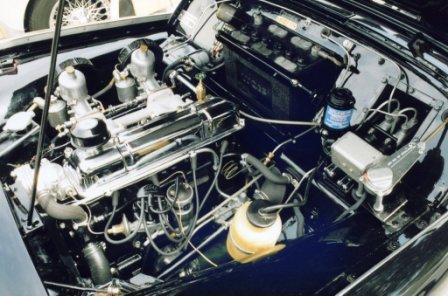

Between 1958 and 1972, I used to check the valve gaps in my TR3A every 5000 miles. Then it sat for 15 years.
In 1990 with my TR restored and the engine re-built (it still had many of the original valves in the head with 80,350 miles on the clock). But after about a further 43,000 miles on lead-free gas, I noticed that I had to re-gap them more frequently until I fould that I had lost most of the 0.010" gap every 500 miles or so. This is how I knew that the dreaded valve seat recession had become a reality. The gaps would close down to 0.004" or closer to 0.002".
So I pulled the head in 2000 and had 8 new valves, 8 new guides and 4 ring inserts for un-leaded gas fitted by an engine shop. The ring inserts were only used for the exhaust valve seats. He ground in the new valves and new seats. I did this in May 2000 and have driven my TR a total of 64,600 miles since then. Because of habit, I still check the gaps every 5000 miles or so but in these past 12 years I have never had to re-gap any valves more than 0.001". A few would be at 0.011" while another might be at 0.009". This was always random and I have no explanation for why up - why down.
I would say that if you have done all the above as I have, you could possibly extend the time to check to about 5 years or more.
But I'll still do mine like I do now.
