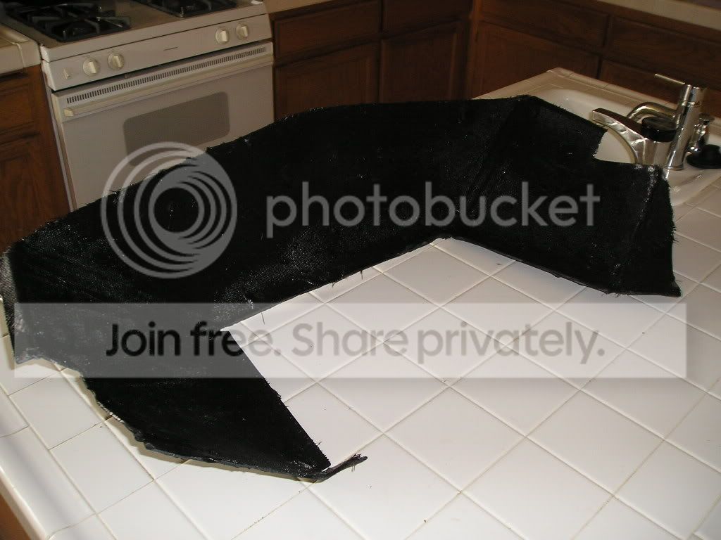

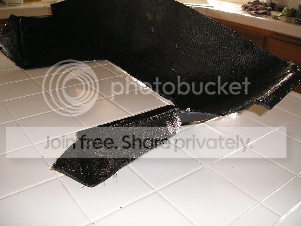

The original valance shroud near the radiator on my
car is still original. Being made of cardboard, I
put a layer of fiberglass on the underside of it and
painted it in place with POR 15 Chassis Black.
Thinking of putting another POR primer paint on the face
side, then paint with black again to further preservation.
Just don't want to lose too much detail, though.

Craig, you know, I've not been much for fiberglassing,
but a vendor that sold POR 15 told me try it by just
painting over the fiberglass. Get the color, get the
hard finish in one swoop.
Tried it. Seems to work real well.
Also told that the POR paint could be used with,
believe it, paper towels. Actually does work, but
would go with the POR silver only with the paper
towels because it actually has some metal in the paint
that makes the finish hard.
POR is some very hard stuff.

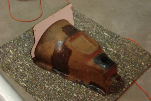

TR674 said:
...My cardboard tranny cover will be next in line for the fibreglass treatment.
Thats how I fixed mine. Works pretty well.
The front edge of the gearbox cover was pretty ratty, but I was able to stand it on end and trace an outline of it onto 1/8" fibreboard and cut out a new front frame, which I glued onto the back surface of the cover, providing a solid surface to mount against the firewall.
I had some tears in the LH side and top of the cover (I think a PO tried to cut it open to get at the clutch slave). Also the bottom LH edge where it mounts to the chassis was torn. I patched these areas with fibreglass cloth and resin, basically painted the cardboard with mixed-resin and worked the cloth into it. Dried up hard as a rock, probably stronger than the original. Cheap, quick and effective. Definitely not concours.
I didn't bother to paint it, since sound insulation and carpet will go on top of it anyway.
