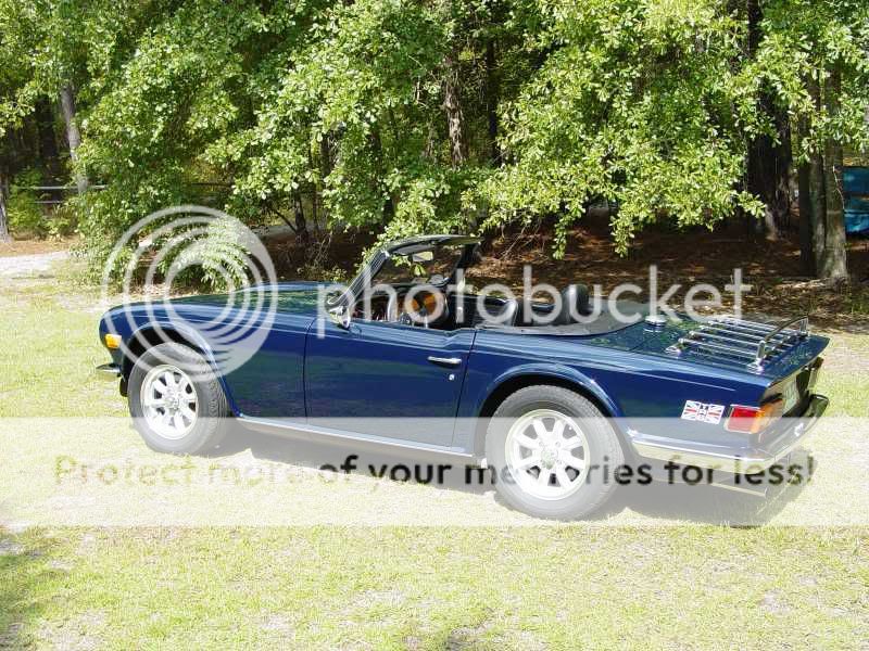

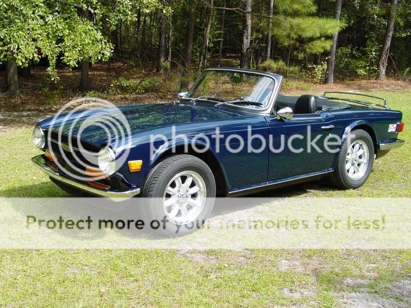

I just finished a complete referb of the suspension and brakes on my 71 TR6 that I bought 6 months ago.
On the front I went with the Roadster Factorys stock height uprated springs, Poly bushings and Koni adjustable shocks along with new trunions and upper ball joints and tie rod ends. New bearing kit along with rebuilt calapers, new Brembo rotors and EBC Greenstuff pads and stainless hoses.
On the rear I used the same type springs from RF, poly bushings, all new Spicer u-joints, Koni shock conversion using the Blind Moose brackets, new wheel cylinders shoes drums and hardware kits.
After a 4 wheel alignment it tracks straight and true and is smooth but it seems to sit to high up in the air now. I did not measure before and after but it appears to be about a inch higher now.
All the pivit points were tightened with the car wheels sitting on ramps to compress the suspension before torquing down.
Hopefully it will settle down some when the parts brake in alittle. It handles good, but reminds me of the way my 78 MGB handled before it was lowered. It feels like it plows into a corner instead of diving in. My 80 Spitfire and my 78 MGB with simular mods, handle better in the corners than the 6 does and I was expecting the 6 to do as good or better than them. Is this a realistic expectation?
What have your experiences been with the uprated springs and does the car look to high in the below pictures?
thanks,
Paul

it does look a bit high but I would expect to see the springs settle a bit fairly quickly. By the way, what aspect ratio tyres are fitted as that may give an illusion of excessive height if they are lower profile than standard. The springs will still settle however.
Alec

When my TR6 was still stock height I had that kind of space between the tire and wheel arch because I was running a lower profile tire. When I lowered the car though, everything looked right.

Seriously, that looks too high to me. Yes, things might settle, but only by MAYBE by half an inch or so. The rear looks like you have positive camber because of the extra height. I really think that the springs are just too long for their increased spring rate. When the spring rates get increased, the spring length should be shortened because they deflect less. Did you check the height of the original spring to the replacement? The replacement should have been shorter. I don't see this settling down any appreciable amount. But, that's just my opinion.

If the specification allows for a plus 2", minus 1", it's OK, but there has to be some allowance for settling and wear. With that being said, Paul's does look a bit high in the front end. I'd drive it a while and let it settle in after 500-600 miles.
Yes it does look abit high in the front.The advice DON'T WORRY BE HAPPY!comes into play. BUT! i think its temporary,& something to think about is 'LOWERING BLOCKS'inserted into a specific area in the coil,It would be temporary at the least until some road time is achieved.Also it won't hurt to find some mild 'SPEED BUMPS'And gently go over them a few times & CHECK THE RESULTS...It may sound quirky but it may work to settle the springs.In any event your showing of your car does ease the pain right?So the world might see the problem..Besides HIGHER is better than LOWER as time goes by...Ken&Whitlightning

I went throught the very same experiences that you have. A complete suspension rebuild with TRF uprated springs resulted in my car riding way too high. TRF took the spring set back (I thought they had corrected this) and I ended up getting my competition, lowered springs from BPNW.
Their springs lowered my car about an inch over stock, which was fine by me. All told, about 2" below the lever of the first (TRF) springs. I know it is a hassle but your won't be happy until you do it again. I have 205/70 tires that are about 1/2" shorter than a Michelin Redline.
They won't settle down enough for you to be happy. After my total rebuild (and the now correct springs) my ride height hasn't changed a fraction in 4 years.
