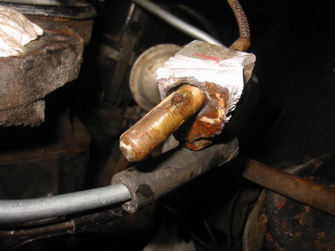

The thermostat housing on my TR3A is really eaten away and paper thin along the back edge. I have ordered a new housing and am trying to get the temperature gauge capillary tube end out of the housing without ruining it. As shown by the attached picture I have cut the housing around the capillary so I have a small piece to work with where I can get around the capillary end. I have been digging and digging with pointed tools trying to get the corrosion from around the capillary end, however, I still have not been able to get it to move all all. Does anyone have a recommendation on how to get it out without ruining the capillary? Thanks for the help!!
