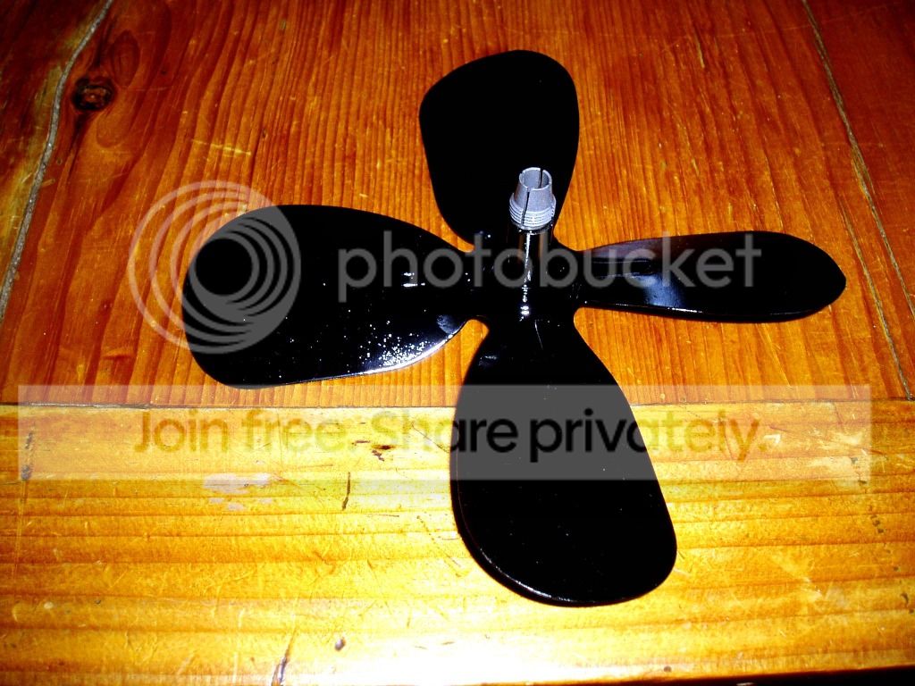

The threads are standard, not reverse. Put a tube wrench on the nut, hold the fan by the blades and sharply tap the tube wrench with a hammer handle. The nut compresses a collet on the fan hub.
Bob
Randall is lacking his usual spiffy pictures so here's mine, for what it's worth Tom
Sorry about that ... haven't touched a heater motor since before I got a camera. TS39781LO appeared to not have had one from the factory and the one I got with TS13571L is still sitting in a cardboard box with a bunch of other useless junk :smile:
Ah, very good! Thanks! I may not have been pushing hard enough in fear of breaking something. This will help a lot!!
