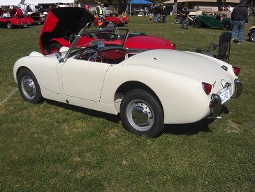

The HD springs from Moss will make the back of your BE look like a 70s dragster, way too high. Don't ask me how I know, but I do have a set in my parts bin. I believe the easy way is to take out 2 or 3 leaves out of the spring set, and then put them on the bottom. Do a search to find out which ones, as it has been discussed before. I tried to do this with the Moss HD springs, but the rear was still too high. I went back to the "old" original springs, that were "just" right. Picture below is with the Moss HD springs.
