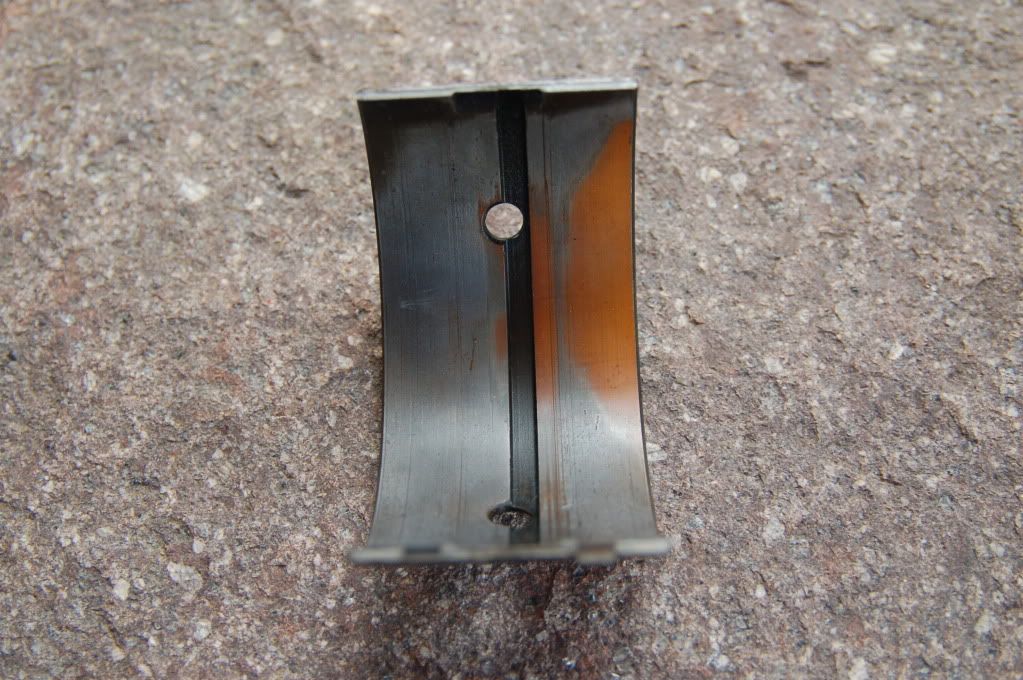

In my case I think, it makes no sense to measure the clearance because the bottom side shells are worn (direction to the sump) This is nothing to discuss, I have to change it in new one.
See the picture . The soft lead indium layer is partially removed and you can see the copper layer. But the inner surface is absolutely smooth.The oil pressure was very good.

From the picture of the bearing,seeing the uneven wear, I would check very carefully the measurement of the crank journal along it's width to make sure that it is within tolerance

I know that risk.... :cryin: this was the worst case shell only the two in the middle has removed lead areas. The on the top and end side looks like new.
I think the new shells wash out on the same area...But
I don`t want to dismout the whole engine. This was an idea to stretch the life of the engine.
