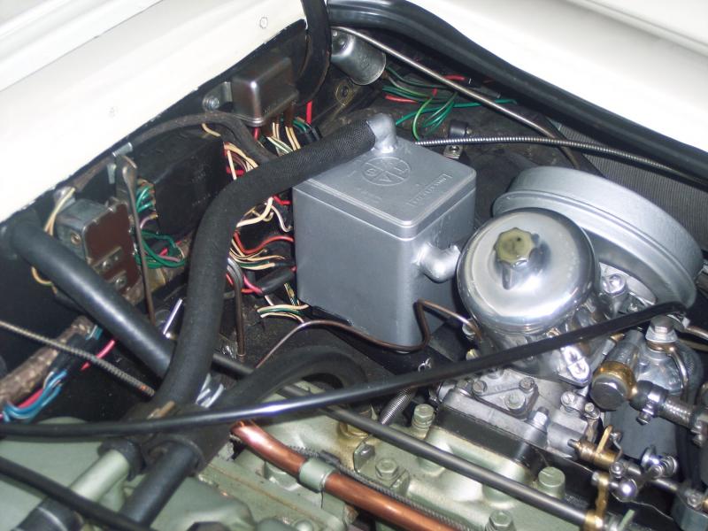

Hi Roger,
First, I agree with Bob on telling your friend to find another mechanic.
Evacuating internal engine gases/vapors through the rear air cleaner for burning through rear cylinder combustion should create any issues unless the volume of vapor is substantial. Should this be the case, you would have more then combustion contamination and misfiring caused by spark plug fouling to deal with. However, as the volume increases, you could intercede with an oil catch can installation between the valve cover and rear carburetor air cleaner to help condense oily vapor and trap it before entering the air cleaner and carburetor air/fuel stream.
Ray(64BJ8P1)

Are there catch tanks (all mounting brackets included) made for the BJ8?
Hi Roger,
There are a number of Oil Catch Cans on ebay and some have attached/mounted them to the frame. They are not difficult to make and I installed a support bottom bracket next to the rear carburetor in preparation of installing a PCV. The original tubing was kept in place (without modification) connect to the catch can or could be easily reattached to the air cleaner. However, deciding not to install the PCV at that time, I was able to easily attach the catch can's outlet to the rear air cleaner.
Ray(64BJ8P1)
