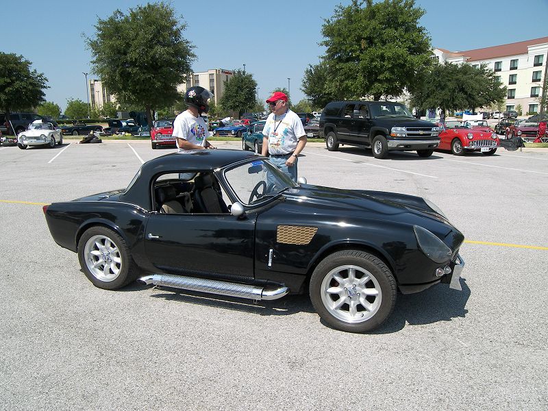

Personally, I'd think twice about chopping the top off a GT6. Spitfires are far more commonly available and generally less expensive. GT6 were never produced in as large numbers and are increasingly rare, or at least more uncommon, so would be more likely to appreciate in value faster in the future.
Just my opinion, but I think a better approach would be to upgrade a Spitfire body and chassis as needed. Much easier and less costly, besides helping preserve one more of the dwindling number of remaining GT6s out there.
Finally, as fun as a convertible can be to drive, the integral hardtop of the GT6 makes for a lot more rigidity that would sort of a shame to cut away. An alternative and possibly the best way to get a Spit to have similar body/frame/handling characteristics would be to install a full roll cage in the car.
