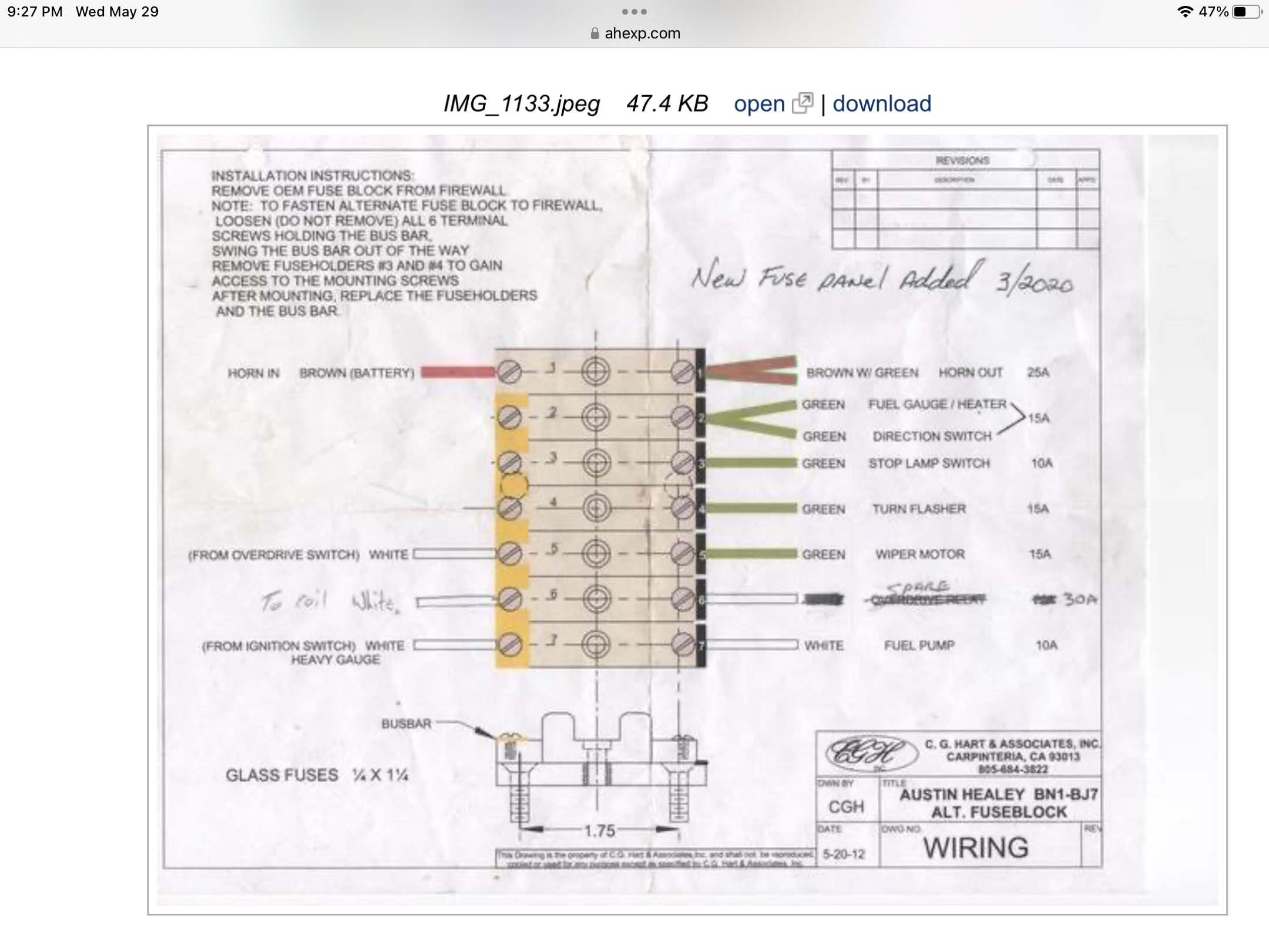

Separate all your wiring circuits , protect your wiring harness and fuse items individually .
Easy to do parts on Amazon for $30 or less .

I am a believer in protecting circuits separately.
The 50 amp fuse has always seemed rather primitive to me and to my mind you may as well be using a 16D nail.

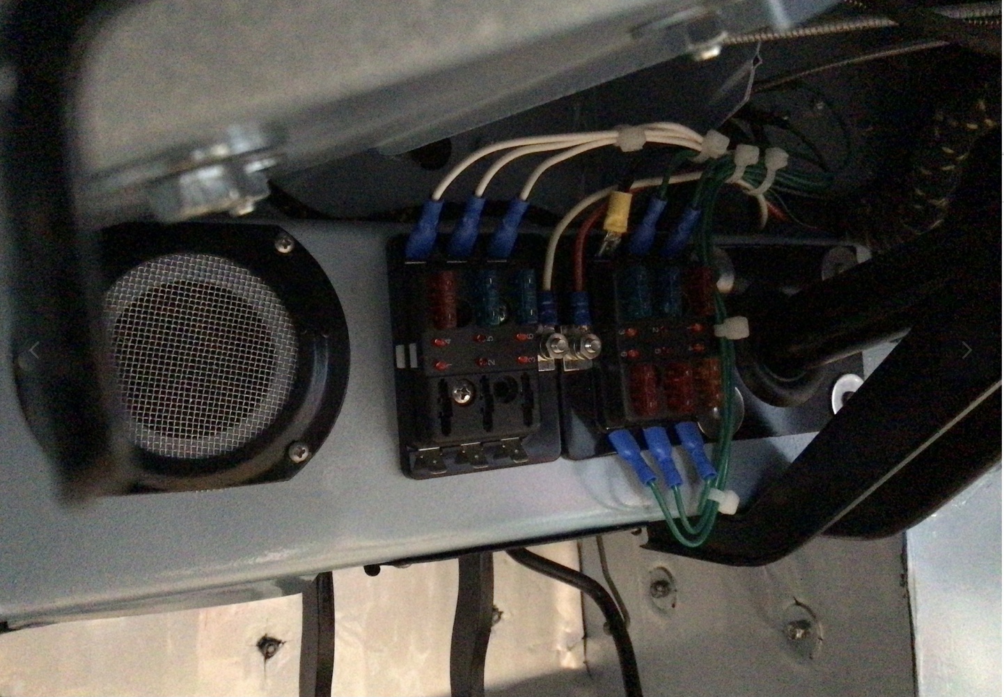

But quite inconvenient when your heater fan takes out your fuel pump. :smile:
That’s a good point Michael. That’s why I have two fuse boxes in my Healey. On is for “ignition on” circuits and the other is for “ignition off” circuits. Please don’t ask me which circuits I put in which box, it’s only been 20 years since I did it. 😁
