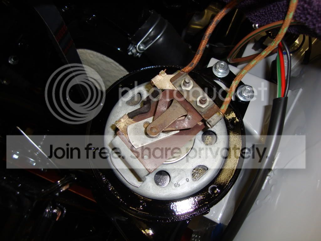

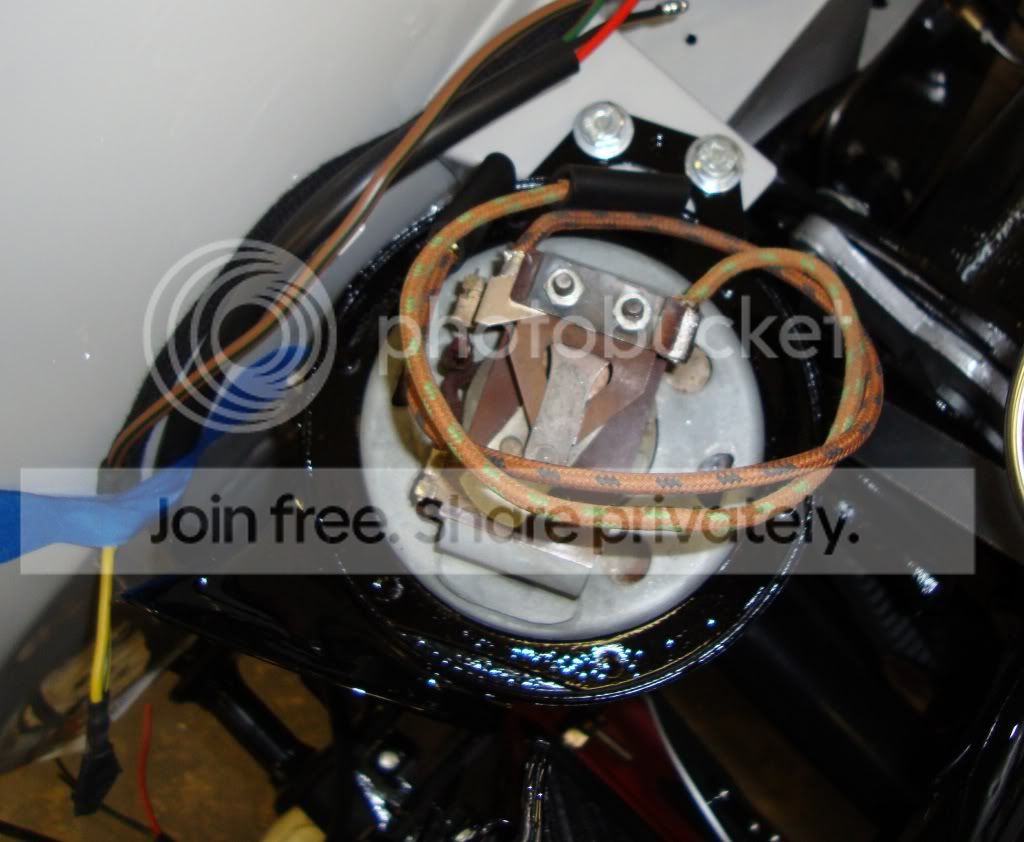

1) Does anybody have a good close up photo of a TR3 horn assembly.
2) Does anyone have a breakdown on dissassembly for the assembly as well. Mine had clipped wires and I am trying to reconstruct/cleanup

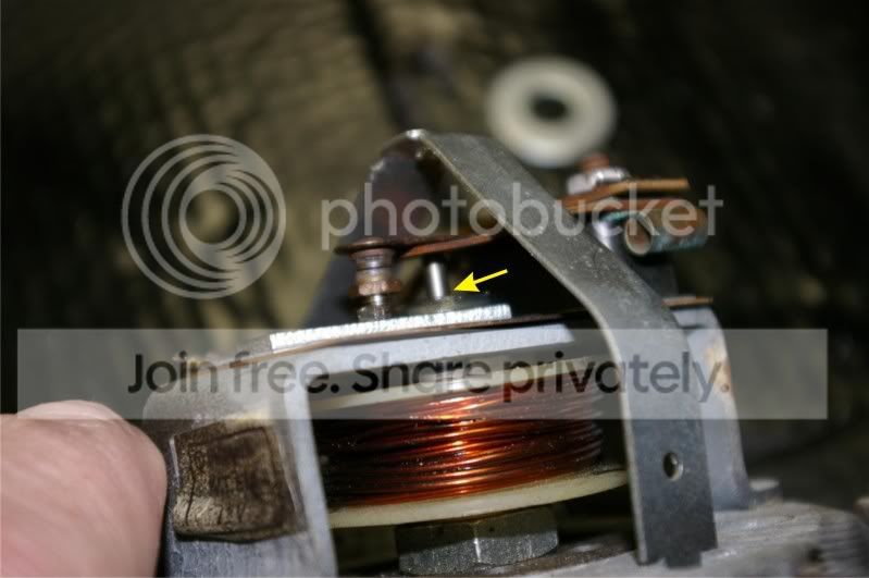

I presume you mean the big windtone horns them selves?? I have a high note in my hand. The Brown wire is on the "upper" of the two connections, Brown/Green on the other. I doubt it matters as I think the connections are electrically isolated from the horn body.Make sure that the pin that moves the points is free to move. You may need to disassemble to do that, just make sketches of how it comes apart. I usually run a drill bit down the hole by hand just to make sure there is no grit, or solidified grease, and clean the pin really well. Connect up to a battery (Large gauge wire, the horns draw a lot of currect), and adjust the points for maximum sound.
Hope this helps a little

these may help - from a friend's website:

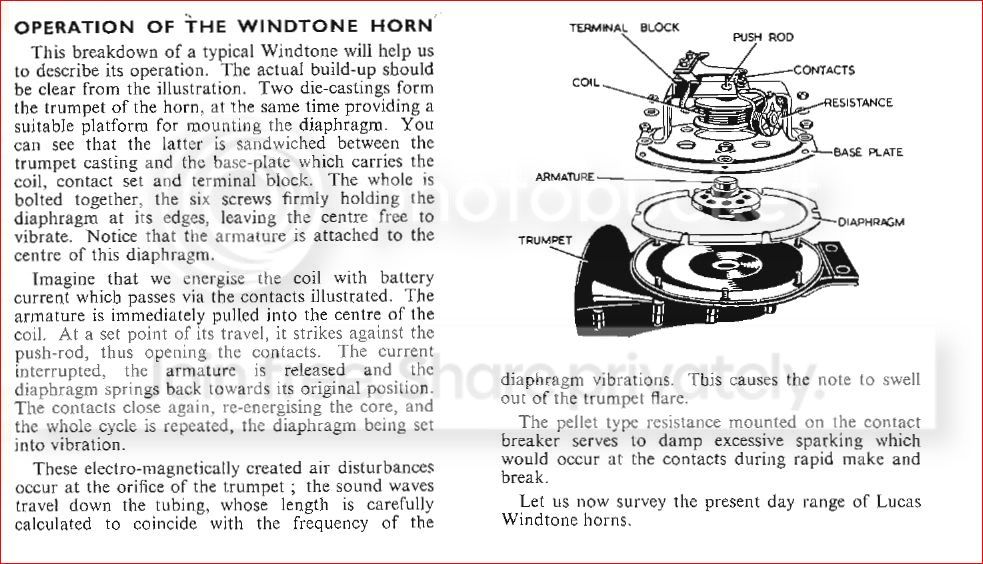

here's a write-up from Lucas. it was used to train their mechanics

The service manual gives a few paragraphs on how to adjust these horns. I can copy it for you if you haven't got access to the manual. If you are not "beeping" it is most likely the electrical contacts are dirty/burned. Second would be the air gap. Both are relatively easy to fix. The manual even specifies regular maintenance of "oiling" the pushrod regularly...Ah, the good old days, when you had a service interval for your horn!

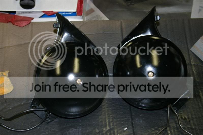

Here's what a little bead blast and fresh paint can do.

Thanks everyone....I am on track....good information as always. The pictures sure did help out as well. Nice work on the cleanup. I have got one cleaned as well, just need to paint. The wire was clipped so I just need to add an extension...

I've just rebuilt my horns. I found that one was working well and the other was sucking double (about 16-18 amps) the quoted current. I cleaned the contacts and adjusted as recommended in the manual and it was only marginally better. A list member suggested adding some penetrating-type oil to the "plunger" to ensure it was moving freely. Cured the problem. Oil to both horns, both sound great, and both now draw between 6 and 8 amps for my WT618 horns.

It only took about an hour to get out the last of the bolts on the other side....that side was rusty....
Before...
During..
The after will be shortly....I have a 4yr old that I promised he could help me paint them...
