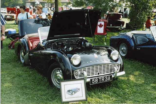

My 1958 TR3A (TS 27489 LO) was delivered with the wedge type sidecurtains with the 4 lift-the-dot fasteners and the chromed door supports as the TR2s and the TR3s. As Randall points out, there were 1337 more TR3As after mine to have this configuation. I prefer these to the later Dzus type.

Russ - I've have owned my 1958 TR3A since I bought it brand new. I was 20 years old and I paid cash with the money I had saved working at Pratt & Whitney in Gauge and Tool Inspection after completing high school.
I'm still 20 when I drive it. I've driven a little more than 100,000 miles since I completed the total body-off restoration in 1990.
