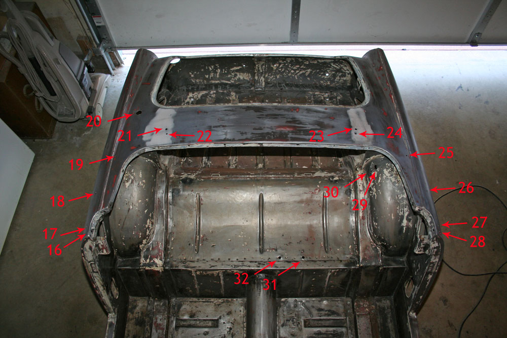

<span style='font-family: Arial'>Please help me get my holes straight in a Midget Mk1! Many of these holes were covered up by the PO and I’m trying to decide which holes are which now that I’ve uncovered them. I apologize if the pictures are confusing or large. I tried to number the holes as best I could. Could someone confirm the “questionable hole” list, please? I’ll use Moss part numbers to simplify things.
Questionable Holes:
1, 9, 13: Lift the Dot Studs 226-600 for a tonneau cover
18, 26: ???
19, 25: Tenax Stud 227-700
29, 30: Nothing was here, just wondering what these might have been used for?
31, 32: No idea here either

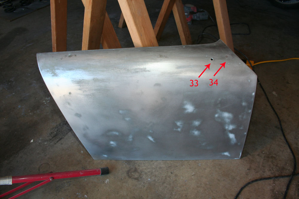

33: Mounting for a one-hole side-view mirror (which I have)
34: Is this a mounting hole for a two-hole side view mirror (that I don’t have) that I should cover back up?

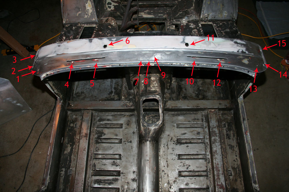

Obvious Holes:
2, 3, 14, 15: Windshield mounting
4, 5, 10, 12: Defroster mounting
6, 11: Windshield wiper hole
7, 8: Rear view mirror mounting holes
16, 17, 27, 28: Mounting holes for turnbuckle
20: Antenna
21, 22, 23, 24: Chrome retainers for the soft top
My soft top has no holes at 18 and 26, so what could they be used for?
