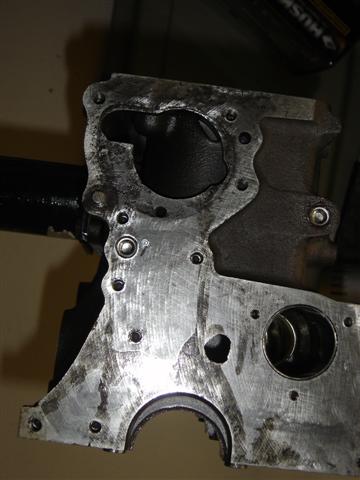

Thanks, puts my mind at ease. I'm going to go take a picture of the front hole and post it.
Here's the picture, it's just to the left of the cam bearing.

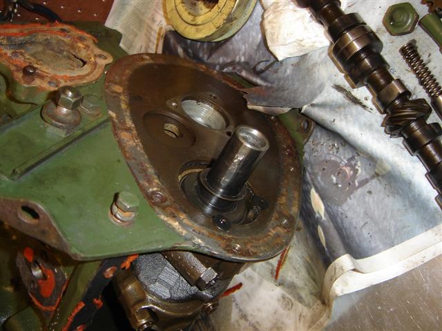

It would be nice if I used the stuff I saved. Here's a picture I have when I disassembled the engine and sure enough...the hole is there...So all is good. Thanks.

It just a splash hole to let oil into the timing chain area.
