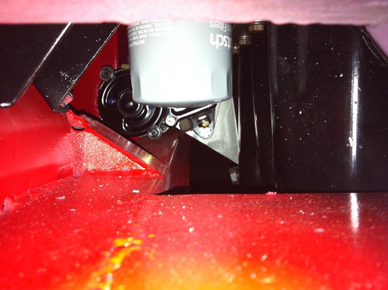

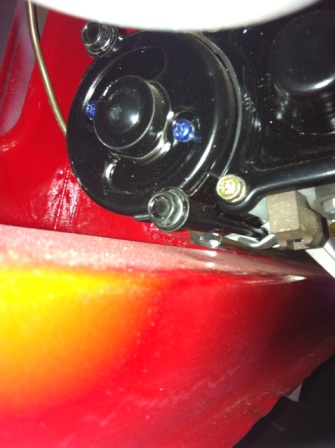

It's for a Triumph, but the starter is the same..the triumph appears to need more measurements and spacers..I did not use any spacers, just needed a bit of clearance on pass footwell corner.
Some pics of my install8-22-12 007_GRS comp.jpg8-22-12 009.JPG8-22-12 008.jpg
This is just the mechanical install..I hadn't wired it up at this point.
