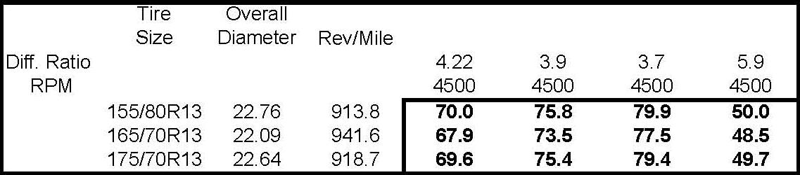

Attached is a table with the three stock Spridget differential rations and different tire sizes, all at 4500 RPM, showing what 4th gear speed should be. In order to be doing 50mph at 4500 rpm with stock tires the rear differential ratio would need to be 5.9:1. This seems very high to me, even for a race gear. I would suspect that either the tachometer or speedometer or both are off.
Chris
[/ QUOTE ]
Well, I did something smart for once. Before putting her up for storage, I wrote down the tires and took a picture of them. I'm running Firestone 155/80R13's.
