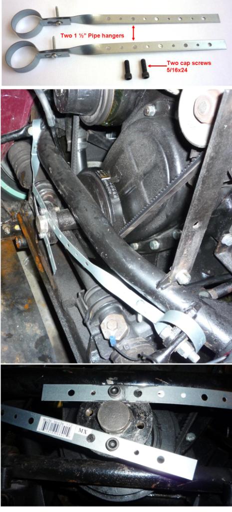

Actually on this, the compressor is more important.
When I did my Wedge for the first time . I tried it by Electric ,then my air impact. My neighbors bigger compressor and finally rented a better one.
Spun right off. Same gun the whole time.
This is how I did it....
