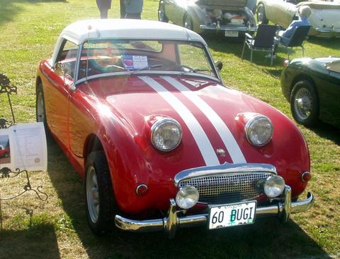

I put a set on Bugsy and the difference in headlight brightness was unbelieveable. Parts Express here in Dayton, they are on the web. 2 Relays and Sockets, a little Heat Shrink and two fuse holders and 2 20 AMp fuses and good to go. Less than $20 for all parts and pieces. Soldering iron to make some good connections and a little time and I was all set. I mounted the relays on right side just underneath the spot where wiring for headlights and turn signals comes out of the main bundle. Parts Express even provide a simple slick sheet on Headlight Relay applications if you ask for it.
After new webbing for the bottom of the driver's seat one of my better upgrades to Bugsy.
