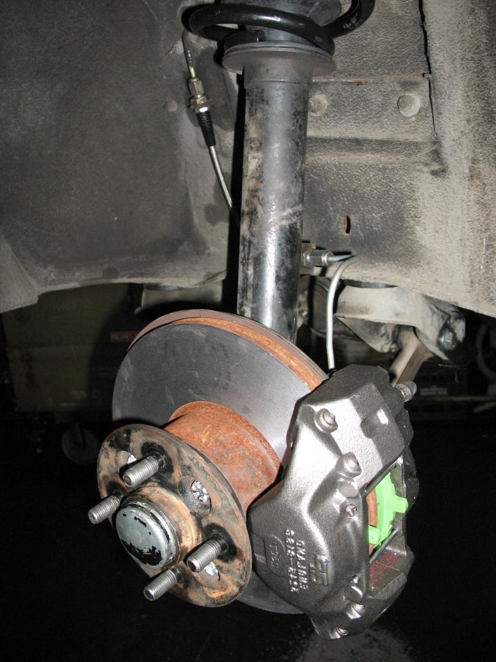

Sorry to bug you guys with something so dumb, i got some EBC rotors, part number GD194. They just dont look right, the stud holes are
threaded, the front to back, or depth, looks to deep, almost like rear rotors. And the tophat part diameter looks to small, the center portion.
I wont be able to get to mine on the car for awhile, so cant really measure mine. Thanks for letting me bug you.

EBC number GD194 is correct, These s/b solid, 244mm dia x 13mm thick, 4 bolt.
Stock disk: IMG_0249.jpg
Brembo measurement Specifications (for TR7 but only overall dia is different):
https://bremboaftermarket.com/En/Car_Disc_Catalogue/Catalogue_Detail_Image.aspx?Code=561ae250-7dd9-4dd7-be15-b6a25b1d642a
M.
Thanks for the help guys, got a picture now. I see my dumba** mistake. Also finallay got into my ROM. I see its bolted onto the back of the spindel.
Tom
