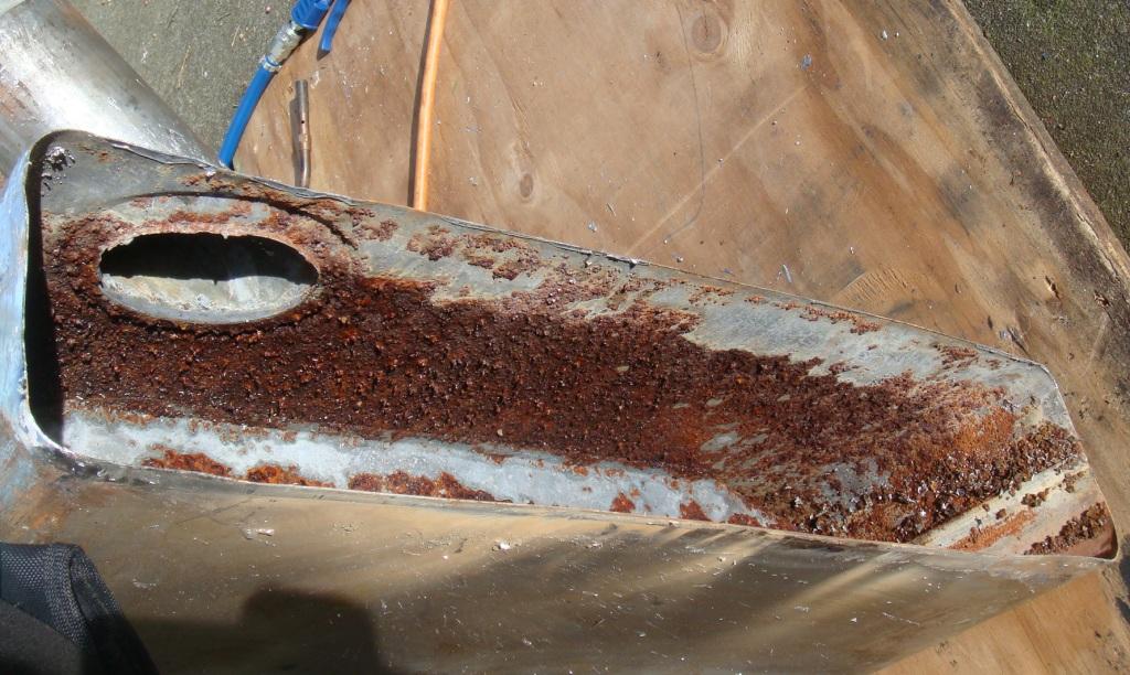

I have just resurrected a BN2 tank and could not get it clean without cutting open the baffles and scraping the muck out. None of the rust colored gunge in this pic is actually rust, it is all fuel residue and has been soaking in hot caustic solution for a week prior to this pic.
