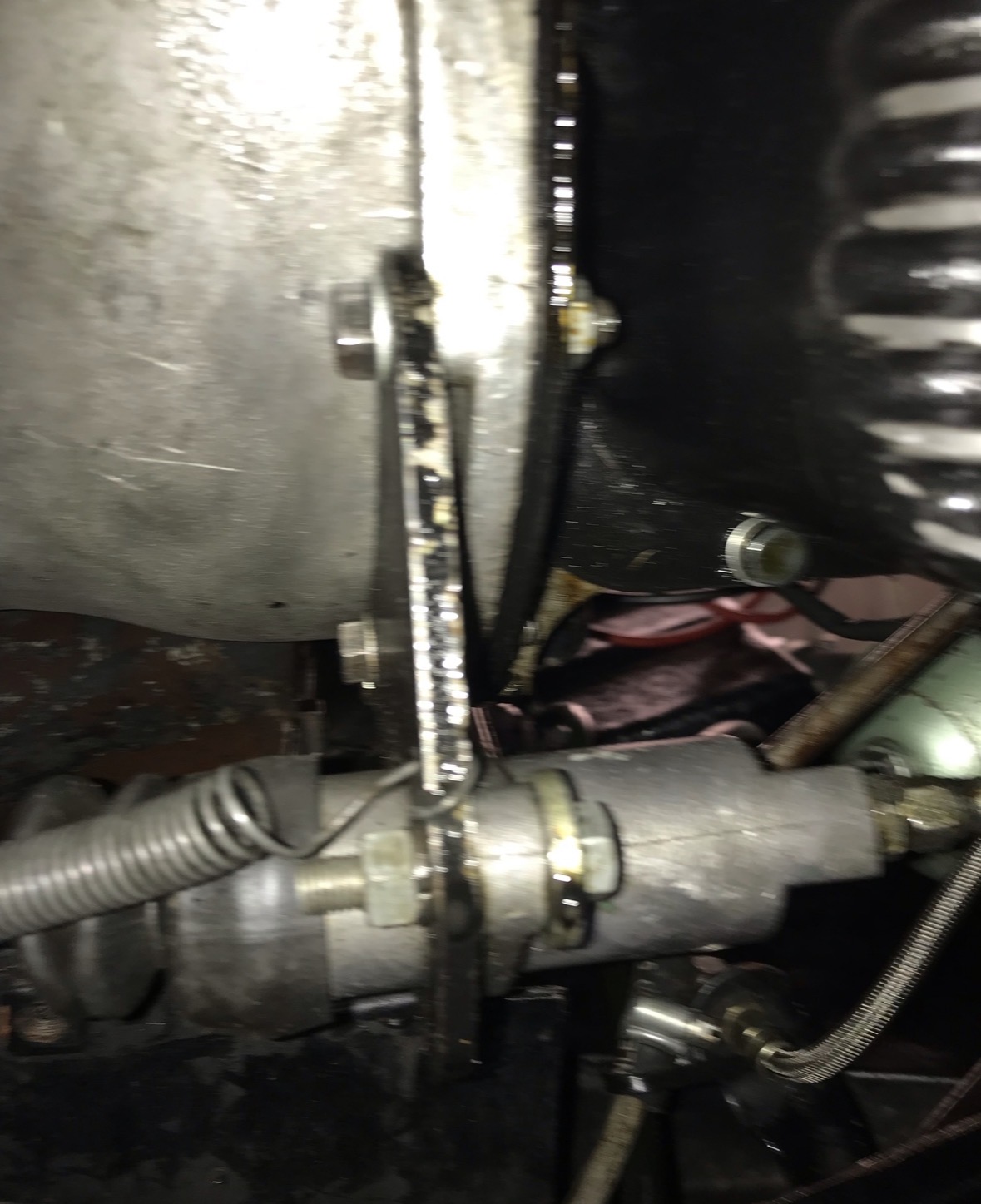

Karl I have an early 6 box in my 3a I used have the early clutch but now use the diaphragm clutch
My slave bracket is fitted to the back of the gearbox flange and the slave is fitted to the front of the bracket and the rod is really short (sorry I don’t have the measurements. And the clevis fits to the middle hole of the lever

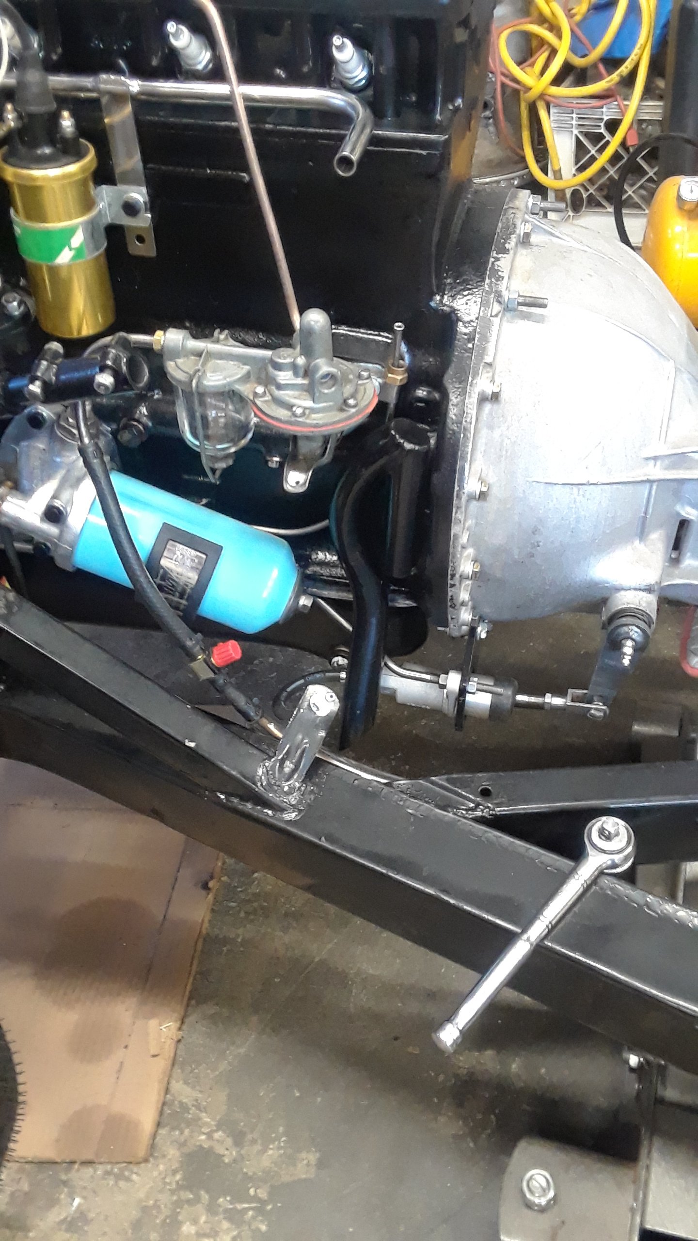

Thanks I'm going to send you a photo of the clutch slave setup that I just did that is the same as your photo. I have not attached the adjustment rod yet but it looks to me that it is going to be way too long? Any thoughts?
Here is a pic of how I was instructed ( by Randall Young) to set up the slave cylinder on a TR3A with early TR6 A type OD. And using a 3 fingered TR3/4 clutch.
And yes I had to shorten the rod a bunch.
Charley

That the same as mine
Just make sure the bleed nipple is at the top and the pipe on the bottom of the slave connections for easy bleeding

Thanks Charley This picture is how I will set up the slave mounting orientation. I guess I got confused by all the written instructions I read on all the forum posts....
Ie. the front of the back of the bracket......the back of the front of the bracket....the word flange used instead of bell housing and the bracket referred to as the flange etc etc. The post that said "on the engine side" and "on the differential side" made the most sense but the picture you sent made everything clear. (y) Also thanks to Hamish for his input. (y) Karl

Charley Do you know why Randal said to "pound the ring gear inspection plate flat when you set up the orientation of the clutch slave " like in your picture when using a TR6 gearbox? I posted on the forum on Aug 2 titled ...In regard to this post RE: Will a TR6 transmission fit a TR3A? In that post I quote what Randal said about it. Karl
Karl,
Best guess here.
The inspection plate has a raised edge that would interfer with the slave cylinder bracket laying flat aagainst the rear of the engine. . You want a flat surface to make sure the slave cylinder does not get a twisted orientation. It needs to face forward and back.
It appears to me that you are overthinkng to much of this. Let your common sense take over and keep you going forward.
However I do agree with you about the long verbal explanation about brackets and flanges and the order they are in. I had to ask Randall at least once for clarification and sat down and drew a picture of exactly what was being said.
Charley
