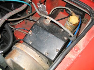

Okay. See attached picture. There seems to be some leakage around that yellowish cap, but down below is dry, and the clutch pedal is dry today.
And what's that black box? And in front of the black box (to the left in the picture) - is that the master cylinder?

Fluid levels are good, and the fluids are clearish, not dark or black like what was dripping off the clutch pedal. I can't find any area of leakage around the brake or clutch reservoirs, other than at the cap in the picture I attached above. I think I'm okay. At least until Chuck gets home to look at it closer!

The black box is called the pedal box. It contains the fulcrums and the "working end" of the brake and clutch pedals. Inside there is where the leak point will be.
In front in the left is the brake master cylinder. The clutch master cylinder is that "Beer Can with a lid" looking thing in the middle of your picture.
If you remove the screws you see in the top of the pedal box and pull that cover off, you should be able to see where your drip is. Then a little extrapolation should tell you where it is leaking. My guess is the rubber boot (gaiter) has filled with brake fluid over time and has now erroded to the point that it has ruptured and you are seeing the mixture of Brake fluid and rubber. (By the way, in case you haven't figured it out clutch fluid is brake fluid and vice versa. the problem might be compatability between the various types.)
Since the reservoir is full and clear, you probably don't have much of a problem right now (other than protecting those shoes!) Check under the lid of the peddle box, maybe you can wipe something off. /ubbthreads/images/graemlins/driving.gif

Thanks Mike. I did take the cover off, put it right back on. That was enough mechanics for this girl for one day! Besides I had to leave to go work phone banks. I'm going to take a good look at it tomorrow evening. Would be cool, if there is a problem, that I could have it fixed myself...before Mr. Mechanic comes home! /ubbthreads/images/graemlins/devilgrin.gif
