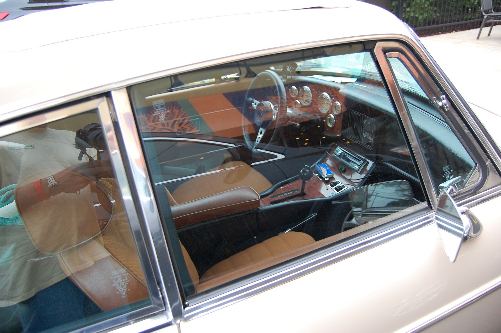

The GT conversion at PVR belongs to Jim Harbold from the LANCO MG club. It's a beautiful conversion and quite a car. We all envied him on the long haul to Dillard, GA in June!!
