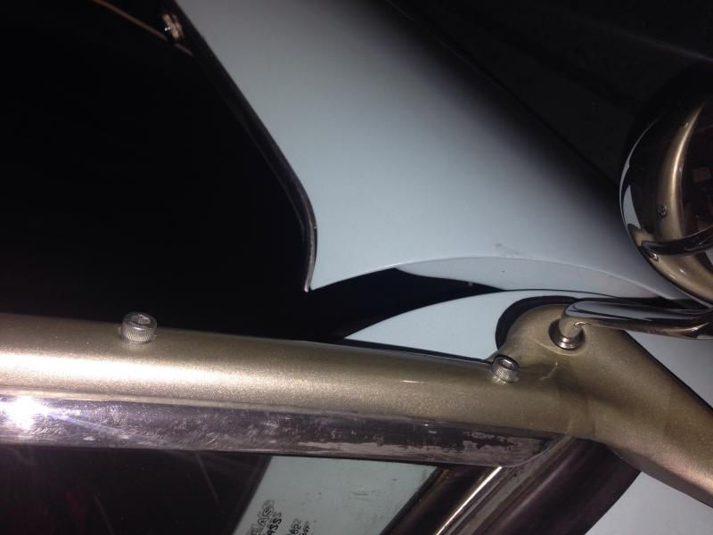

I did the same with mine and used stainless socket cap Allen screw. Not factory, but I can pull them again, without trouble.

Not to countersink, but I think I may have had to increase the hole diameter very slightly.
