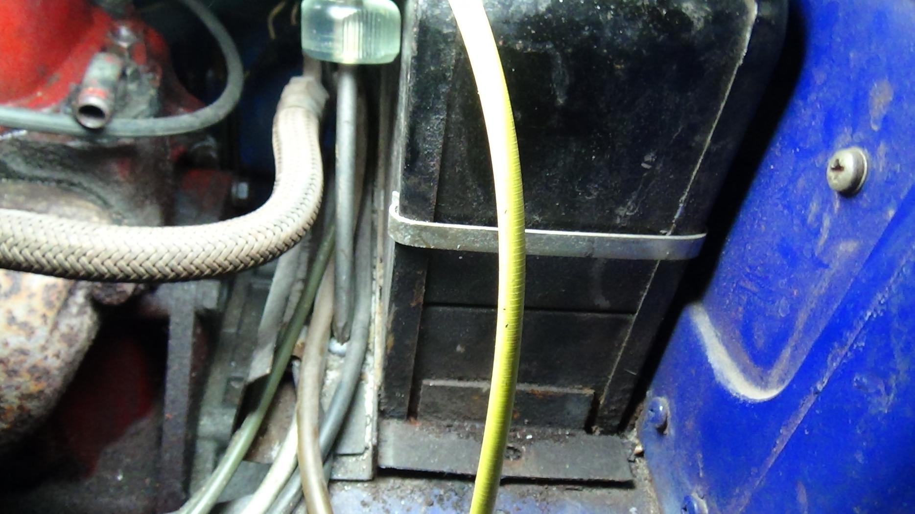

How many screws hold the box in place? I removed the big one at the top that goes into the firewall, and a rusty one on the left end, near the throttle cable. When I pry the box lifts a little and the top of the box tilts toward the front. I hear some crunchy noises, as if old dry gaskets are giving way.
There is a tray that runs along the bottom front of the box that holds the windshield washer hose, the blower wires, a brake line, and maybe the clutch line. Under all of that are 2 screws. In the attached pic the screwdriver pointing to one of them.
Are they holding the box down?
I have also pulled the defrost tubes out. Does the box pull straight up, once free?

Well, now the picture is attached.

There should be a screw on each side and three across the front (if memory serves). The tab on the top with the one to the firewall. It should come away with those all removed. The circular gasket sealing the blower outlet to the firewall can be a bear. The control cable inside the lower part (under dash) needs to be disconnected as well. Then it should come straight out.
When you put it back, use new rubbers (Moss), allow for plenty of time. Lubricate the rubber with a non destructive lubricant, such as silicon and have patience. Removing the heater is easy, you'll realize that when you start to put it back in. Reconnecting the cable in the box is a bear, you need to be a contortionist! You might add a few new words to the English language, but that's normal, don't fret! If I had a choice, I'd rather change a transmission! :livid: PJ
