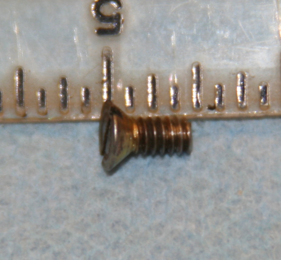

How to you attach the heater booster knob? I can see a hole for a screw in the bottom of it but I don't have any of the parts to attach it?? Thanks!
DT
There is a single machine screw, flat top and beveled bottom, that screws through the bottom of the knob into the handle.

Hi DT,
I took mine out and sized it up. It appears that a 4-40 machine screw should do it. It is definitely a 40 pitch thread, but the size might be some off British size. I did not have a 4-40 machine screw laying around to test it. The overall length is 1/4". I have attached a picture of the screw.
Hope this helps.
Mark

be careful, the threading may in fact be British Bicycle Standard. I know the lock fixing nut for the glove box lock on the BJ8 is this odd standard.
