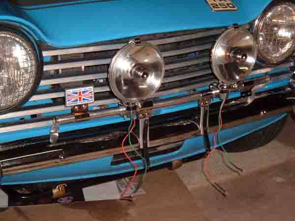

Hear's what I came up with- light/badge bar
Got_All_4

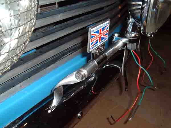

About a month ago I was asking about a light and badge bar for my TR250. There is nothing out there unless you want to pay almost $200 from Revington. I went to a salvage store and bought some 3/4 aluminum round stock cut it to length and polished it in my lathe. Then took some 1/8" flat stock and made the end brackets. I used badge bar clips to sucre the bar to the stabilizer brackets that attaches to licence plate bracket holes. Got about $65 in it + the lights.
Could not figure out where to place the light switch. Heaven forbid that I drill the dash or the dash support. Had many suggestions to but it where the TR6 courtesy light goes. What do you think of hooking it directly to the head light switch. After all that is the reason I'm doing this. I received as a gift the H4 European head light conversion and don't like them. I plan to run these together and shoot the driving lights down the road.

Last night I plugged the lights into the harness, One bulb blow out instantly. Looks like a used Brownie flash bulb now. But was pleasantly surprised the difference that one made. Just got to figure where to mount that switch and that's what I'd prefer.
Looks good, I like how you integrated it with the license plate - where'd you get the clamp arrangements for the lamps?

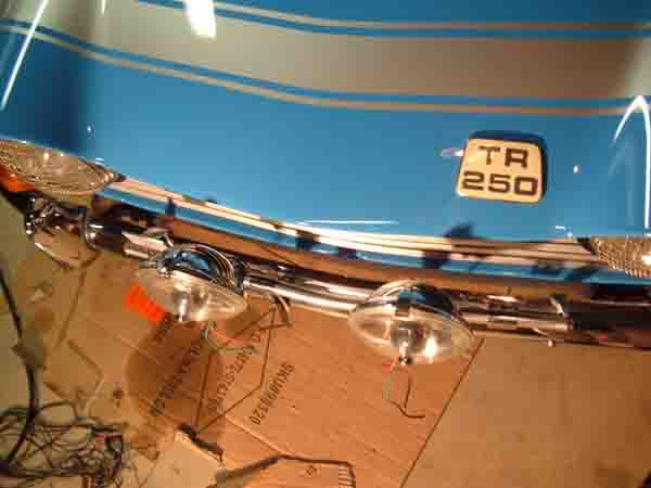

Ya no problem opening the bonnet. I designed it with it opened so I wouldn't have that problem. I first had the lights out near the ends of the bar so it would fit into the the low spot in the bonnet when it was opened. Didn't like the driving lights here. However the badges looked great in the center. Lights work and look good where there at now. The badges so so.
When I test drove it the I pluged them into the low beam and when the dipper was pushed the driving lights went off and the brights came on. I'm sure it workes the same when pluged into the brites
