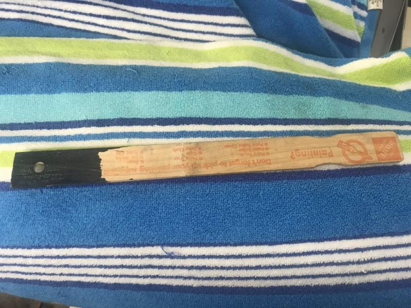

So, I disconnected the coil wire from the cap, used my handy-dandy plug wire holder, held the distributor end of the coil wire to the center of the rotor, and using my remote starter switch cranked the engine over.
The bracket that holds the Crane optical pickup used to stick up above the pickup. I cut off the unneeded excess and all is well.
The spark will jump ~3/4". I'm not sure how much voltage that translates to, but it's a lot.
