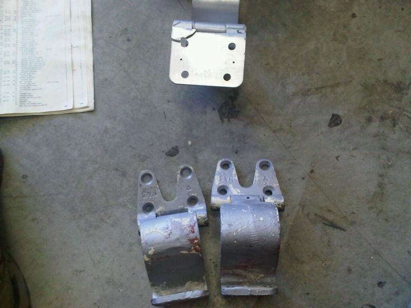

Well, I was having trouble closing my door on the BJ8. I took the door off and the hinge was broken where it attaches to the door. I do have some BJ7 hinges. Are these the same as what is sold by the various suppliers?
I noted that the original is all aluminum. The BJ7 is part steel and part aluminum.

HI Jerry, while BJ7 and BJ8 doors Differ slightly the upper and lower hinges are all the same to the best of my knowledge.-Fwiw--Keoke
Thanks Keoke. Lucky I had extras. While the door side looks different, you can't see the door side once installed.
