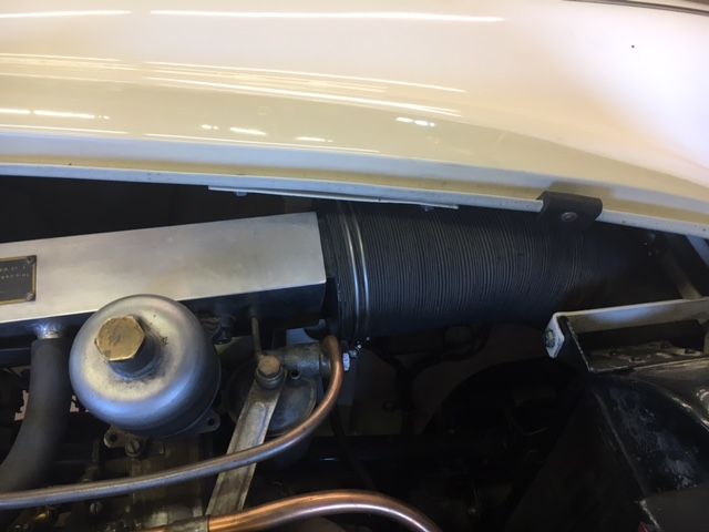

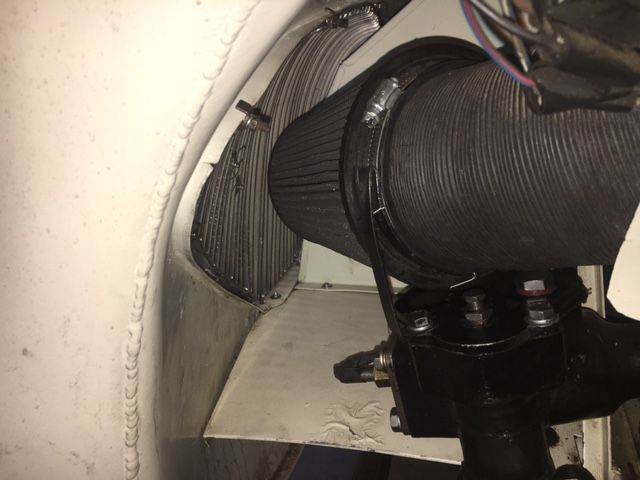

That may have been me. I read an article years ago about a 100 racer who tested on a dyno and found velocity stacks yielded more HP than the CAB. I used the DWR adapter and some of the rigid tubing as used in the fresh air port, fashioned an adapter bolted it to the top of the steering box with a K&N filter (the adapter had to be modified to fit the tubing).
Never thought of strapping it to the steering box. Great idea! Thanks

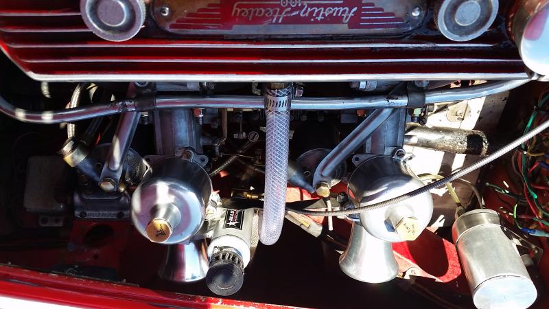

I recently put in velocity stacks in place of the CAB. I really have not noticed any increase in performance but they look and sound great and my forearms appreciate the swap. At the time of this photo a small breather/reservoir venting from the valve cover was still installed, clamped to the front velocity stack, but I removed it when I last adjusted the carbs and have gone to a straight hose since there is no perceptible blow-by.
View attachment 49124I have ordered a K&N RU2590 filter and will try to match your setup. Someone posted to use a trimmed tuna can to give it support. Here is the post I found: This read-only message was archived from a public mail list.

I recently added a small set screw at the front of the CAB to keep the adapter from sliding out. I try to keep this car as original as possible, but I'm not fanatic about it (note the rigid tubing and adapter aren't OEM; at the factory they just slapped some flimsy SCAT-type tubing on it with a band clamp and called it a day) . I live in the (sometimes very dusty Central Valley) so going filter-less isn't an option IMO. Now, I have to take it all apart to figure out how to get corn head grease into the steering box (a buddy sent me a couple tubes kinda as a joke when my box peed all over the garage floor, but I'm going to give it a go; a very respected Canadian restorer said he puts in all the cars he fixes).
