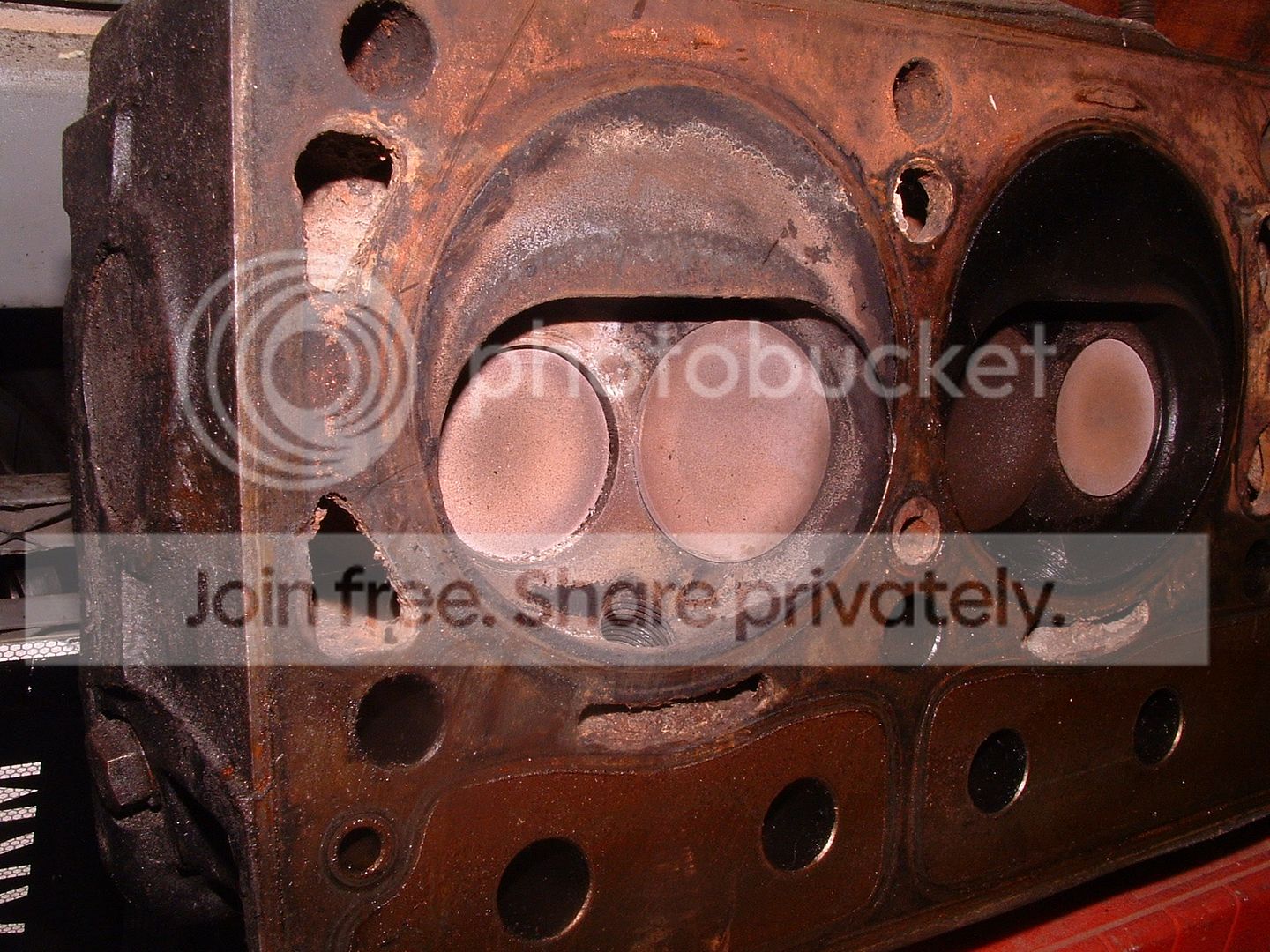

Here is the end result of my intake seals and external oil feed :
One of the seals came apart and allowed one cylinder to suck too much oil past the guide, which was severely worn from lack of lubrication (some previous mechanic had apparently installed the rear cam bearing wrong and no one, including me, noticed for a long time). Oil has a lousy octane, so that one cylinder was knocking under cruise conditions, and the knock eventually broke away the piston lands below both compression rings.
