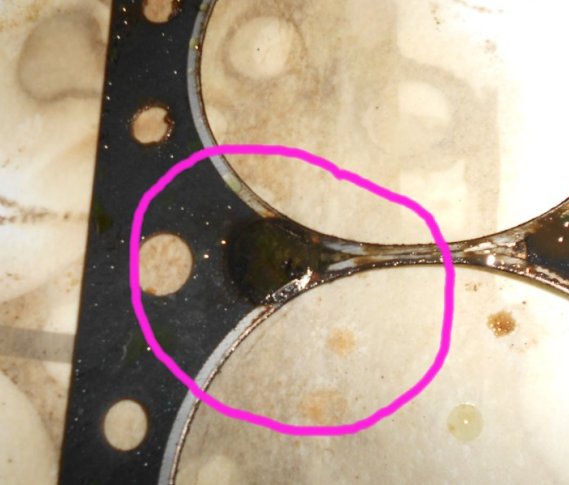

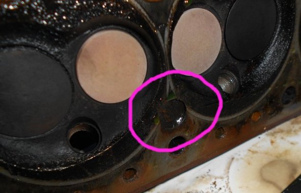

Your sympathies gladly accepted. My 1275 first developed a sputtering at high speed (or under serious load), then got a bit worse. After fooling with timing and carbs (endlessly), I finally pulled the head. Ta-da... the coolant blanking plug (that I've read Hap posting about) was recessed about a millimeter on my 12G1316 head! This is between #2 and #3, and is not quite the same as blowing a gasket between cylinders, but similar. The plug spans right across the fire-rings on the Payen gasket. Dang. Going to replace the head. :frown: The rest of the messy head is merely from me being careless removing it. It's funny... the car would run OK under a light to modest load.
I guess one can have that plug drilled and re-plugged, but this might be a good time to go to a very clean 12G940 that is ready to go with non-lead seats (and fully tested).

Not familiar with his post. Is that something that happens over time with vibration? Or a misnset plug from the factory? It looks like it would cause bleed over predetonation to me. Which makes sense with what you discribe. The hard the load the worse the bleed over. Is that something I need to worry about on my all stock 1973 - 1275?
Not sure, but there are several posts out there (here and in the MG Experience forums). Evidently, the plug can work its way in, and, yes, strang detonations will happen. I don't think it's a super common condition, but something to keep on the look-out for. In serious cases, there will be a bad leak of coolant (but at least that will be an easy diagnosis). I think mine was possibly assembled without the PO knowing what was there (because it was there from the get-go, only it got progressively worse over several hundred miles).
Found 2 posts (that include tips from Hap on this):
https://www.mgexperience.net/phorum/read.php?1,2096990,page=1
"Ok with you doing retorque and seeming to get a seal I doubt this is your issue, but it's worth mentioning and something alot of folks don't know about. On the A series heads, for sure the 1275 head, there is a brass plug that barely intersects the fire rings on #2 and #3 cylinders that sometimes can with heat countersink itself into the head casting, if it does this, then you will get water directly into cylinder #2 and #3, I guess in the last 15 years I repaired atleast 3 1275 heads that the plug drifted upward, or was completely gone."
In my case, there was no water issue but a cross-fire between cylinders.
https://www.mgexperience.net/phorum/read.php?3,2112483,page=1
"This has probably nothing to do with your issue, but I thought I would share with the group. When rebuilding a A series head, one should pay close attention to brass plug in the head surface where it bolts to the block, there is brass plug there, it intersects #2 and #3 fire rings of the head gasket, and it known to counter sink, even fall into the head, if it is not there, then it will dump water directly in to #2 and/or #3 cylinders, and most folks would never recognize it's absense if not there, if it is countersunk from the deck surface of the head it could cause a head gasket failure. I'm doing a 1275 head rebuild right now and the owner ask me to not do a resurface if the head was straight, howeverr I found a issue that required resurfacing, I first check the combustion chambers to confrim they were stock, they were, but this brass plus was countersank about .007' in the head, so we did a .010" resurface to elminate the counter sunk plug issue. I've had tow cases where these plugs were totlay missing and in that case developed a nice repair for this, I thread that hole in the head deck for NPT plug, I use a brass square peg NPT plug, Install the brass NPT plug with JBweld on the treads for seal, cut most of the proud section of the plug off with a cut off wheel, then resurface the head until it cleans up where the plug was install, in this case truely better than new, because the threaded plug is never going to move."
Again, in my case, the plug settled in about a 1/16th of an inch, and the gasket dimpled in right there but with no coolant issues (and this is right across the fire-rings). Not good.
I have posted about this as well. I had this problem but I had a good used head that I cleaned, lapped, resealed and used. The brass or bronze plug expands at a different rate than the cast iron and over time repeated heating & cooling cycles will push the plug into the head reducing gasket sealing in the area until gasket failure occurs. Gasket replacement is a temporary fix. This plug should always be replaced when the head is rebuilt and it should be flush or very, very close to flush if a used, non-rebuilt head is to be reused.
This recession issue is accelerated when the engine runs hot. The more heat, the more expansion resulting in more recession.
We would be wise to help all members who seek engine rebuild info by mentioning this issue in any engine rebuild thread.

Excellent points Tom (and I'm surprised how many people don't know about it). If I keep the head, I will insure that the plug is done over and done well. Thanks.

Stripped the head apart... found sticky exhaust valves (seriously so) in #2 and #3, which makes me wonder if that area got really hot and THAT caused that blanking plug to recess. Either way, those valves were darn sticky. Furthermore, my straightedge reveals some warpage, and given this head has been seriously skimmed before, it's toast (given I have about 5 things wrong with it).
On a positive note, the valves, springs and even guides look very good. Perhaps the head was poor to begin with and when the trouble-some valve guides were stuck in there with some distortion. I could fix it all, but the prior skimming and was just too extensive. I see I can get a nicely preparted 12G940 with APTFast, which I might consider (hardened seats, fluxed and blasted). Decisions...............

I also think I had sticky exhaust valve guides in the same area... because if they got hot, they may have temporary gripped the valve-stems there. I suppose I'll never know what the cause was (because those guides will be fixed one way or another). Regardless, IF that head blanking plug gets worse and worse, two things could/will happen: 1) gasket failure between #2 and #3 that won't go away by letting up much, and 2) the plug could even fully recess and THEN you'll get coolant-related issues.
