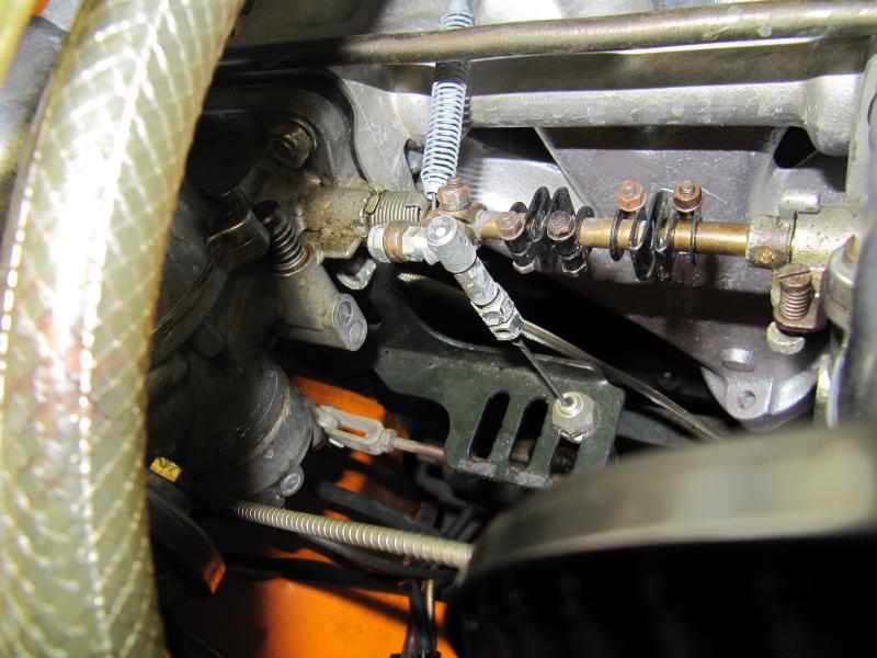

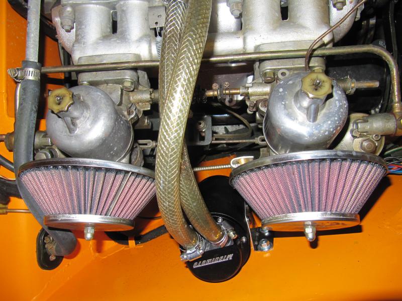

Not on a TR6 but I have HD6 on my TR3. Had to buy lean needles but I got more power from the engine. Another guy in our club that also has a TR3, remarked on how much more power my car has. It can keep up with Healeys. I did install a cable to work the throttle since the controls are different. While the 4 vs 6 cylinder Triumph engines are different, the HP that comes out is not that far apart.
Jerry - thank you for the input. Good to hear from someone who's actually done it. Can you post a picture?

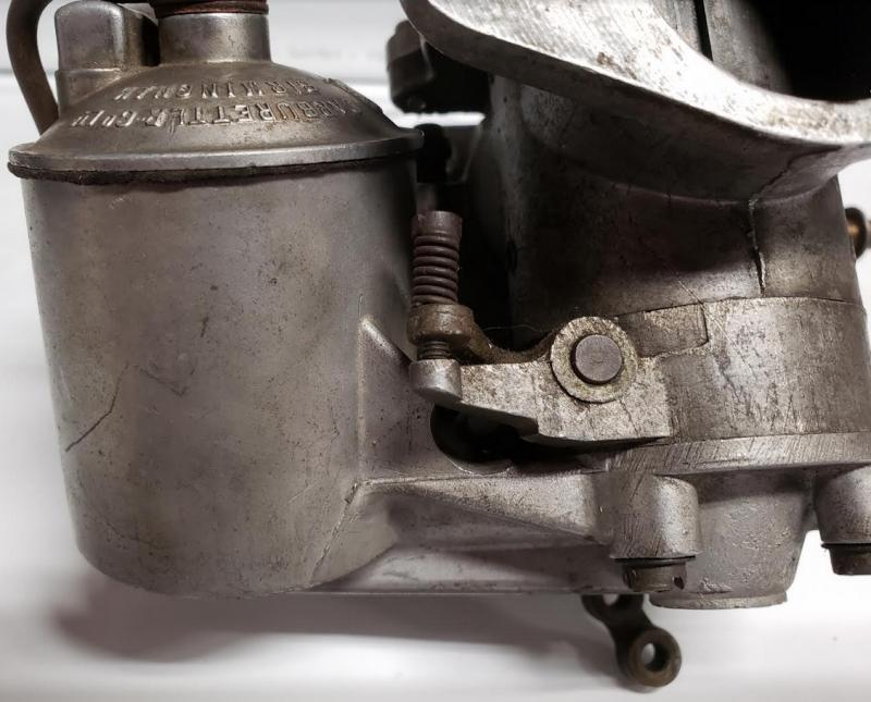

I put older Zenith Strombergs from a TR4 or 4A on my TR250. They are much simpler carbs, not really any different than the same era SU other than the rubber diaphragm to seal in the vacuum. Not suggesting they are better than HD6s, but another option. They are not stock of course, but they do look closer to the stock item than SUs.
