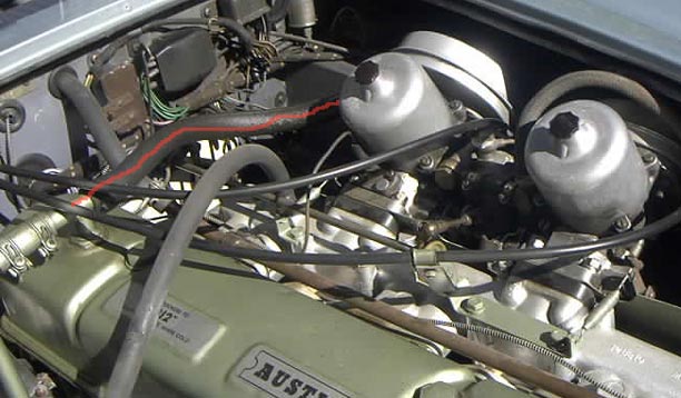

One thing I did do recently was to remove the value breather from the 2nd carb.
Based on the advise of an "old-timer" Brit mechanic the rear carb. doesn't run rich now and the 3 rear spark plugs run much cleaner.
"value breather from the 2nd carb"?
w
Hi Walter,
Dougie is talking about the hose that goes from the "T" on the valve cover to the air filter. See the red line in the photo. I will guess that a filter has been installed on the "T".

Greg,
Thats exacting the hose I was referring to. I guess it is technically venting from the "rocker" cover. Thanks for clarify this.
