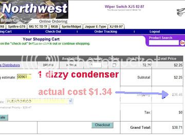

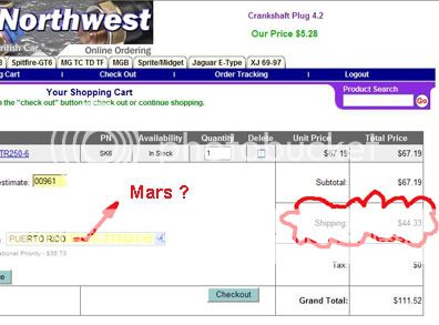

poolboy On 7/15/07 said:
<span style="color: #990000">For the fun of it, I checked again to see if they
had modified their profittering on shipping costs.
This is right off their order form. I guess I live on Mars.</span>
$36 to ship a condenser can? Phil sent me one for $1.34
