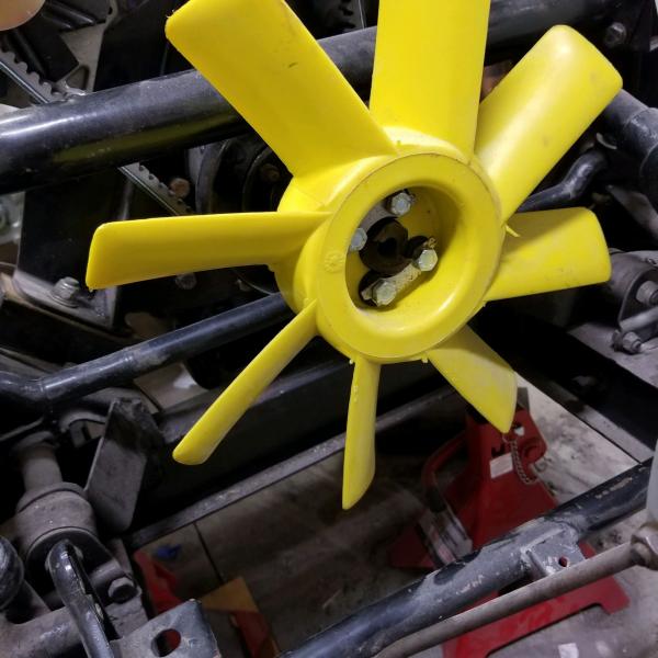

Have I mounted the yellow fan backwards? I mounted it with the flat face towards the motor and the recess to the radiator. When I went to put the radiator on the car there was not enough room to get it in.

I believe you have it mounted as designed - but some have had to mount it backwards to get it to fit.
On my TR4 I had to mount it backwards and make a spacer (from a cutting board) to make it fit.
Mounting it backwards has (I think) only a small effect on performance (the blades have a slight airfoil). The fan, of course, blows the same way whichever way you mount it.

When I looked at The Roadster Factory page showing the fan I could see from the photo I had it the wrong way around. Reversed it and checked that I can get a belt on past the fan. You have to rotate the engine to get the belt past the cross tube but it fits Ok apart from that.
I need to align the crank hole with the radiator hole. I presume I use the shims that go between the mounting block and the engine mounting plate. The rectangular shim with a slot.

Yes, alignment is via the shims, this shim:

I have a stack of them. Not sure if the PO purchased some or if they came from the car when he stripped it down.
It looks like I will have to put more on one side to move the crank to the center of the radiator. May try centering it by moving the mounting blocks first.
The crank hole is low and off center to the radiator hole.
David
Got the crank handle centered on the radiator. It took 3 shims on one side and one on the other. Also I had to slot the 2 bolt holes in the rubber mounting blocks so that I could shift the motor sideways a fraction.
