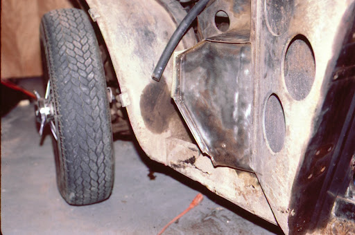

Also california cars are rusty inside the back inner side of the front fenders. Check the fender corners,california cars are very sandy, (desert area) with some water the rust in the corners will grow...
Check the doglegs ( part from back fenders)near the rocker panel.
Check serious the rocker panel ! There are three parts !( outside /inside and a middle sheet panel)

Attention in your IMG_0743.jpg you can see a crumbled triangle stiffener panel! Reason.. ?
