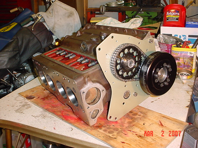

For a slightly different approach, I used the ATI "Super Damper". Instead of the rubber being bonded, it uses Elastomer O-rings which can be replaced if needed. The number & hardness of the rings are selected to match the engine vibration characteristics. The hub & outer ring are one piece with the inner weight ring being rubber mounted. No danger of the outer ring slipping & changing timing marks or breaking the bond & coming loose. As a bonus, the outer ring has 360 degree engraved timing marks.
https://www.atiperformanceproducts.com/products/dampers/101/index.htm
Denis Welch obtains the outer damper & rings from ATI & makes inner hubs to fit the Healey Fours & Sixes.
https://www.bighealey.co.uk/search.php?keyword=damper&Search=Search&cat=1
See the attached pic.
I find that I can turn the long stroke Four, which is originally redlined at 4,800 rpm, easily to over 6,000 rpm with this damper & a good crankshaft. A great investment for engine life/longevity, though not cheap.
D
