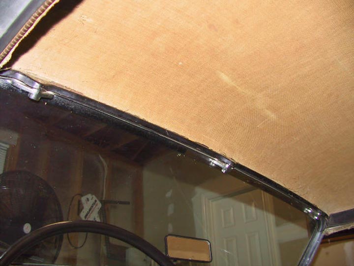

Apparently, some had fabric simply glued to the metal; others had the fabric supported by bows. I don't know why or when the difference, but my top has the remains of the bows & hanging fabric, while the photo below (from Carl Musson I believe) is supposedly original as well.
Hmm, I just noticed that Carl's photo also shows the post-60K rear view mirror, while my car was much earlier. Perhaps that explains the difference in headliners ???
I never liked the hardtop much, so it's been hanging in the garage rafters for over 20 years. Not sure I'll even bother transferring the fittings to the project TR3.

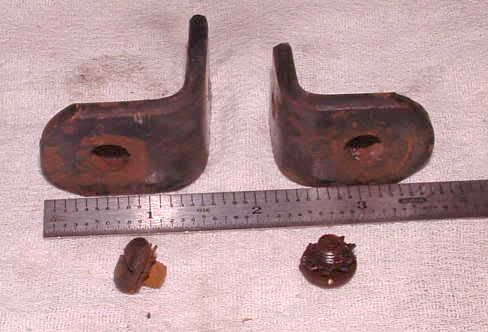

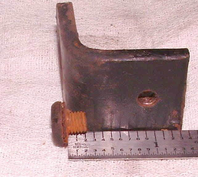

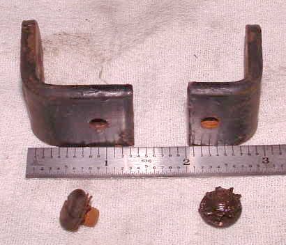

Mine has the single band and the entire inside is coated with a textured black, red underneath.
I purchased a foam core automotive headliner material from ebay that I will put underneath the band and fold and glue the edges.
Thanks for the excellent pix, Randall.... looks like I'm going to try out my fabbing skills sometime soon...
