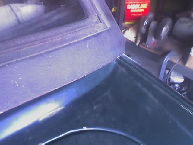

The area that i'm looking at the most are the corners, it starts out matching the body lines but it doesn't follow the curve in the back. I'd say the corners sticks out about an inch, the back of it seems reletively straight but the body has a curve. If i can find a way to get pictures to the internet i will post them.
Now I'm wondering if the hardtop is correct for the car...there were 4 different factory hardtops for the Midget & I've found that none fits all...I've got an extra hardtop just because of that!
here are some pictures of it, i hope it helps

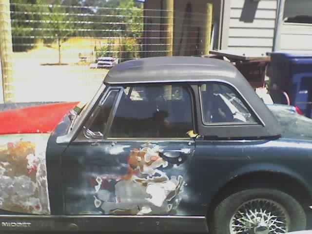

There was only 1 photo but from what I see, its a factory hardtop...need to see the side of the car with the hardtop on it.....what year is your car?
See post below (sorry for double post)
Problem is, you've got a factory hardtop for a MkII Midget - it won't fit your car which is a MkIII....see that indented area in the front of the top? It fits the earlier body...I've got an extra one of those tops for the exact same reason - I wanted to put it on my '74 RWA MkIII Midget - won't work!
The correct hardtop for your car should be straight all along the bottom.
well that explains why it doesn't fit, I wouldn't think the MkII would be that different then the MkIII. I guess I've got some figuring out to do. Thanks for all the help!
