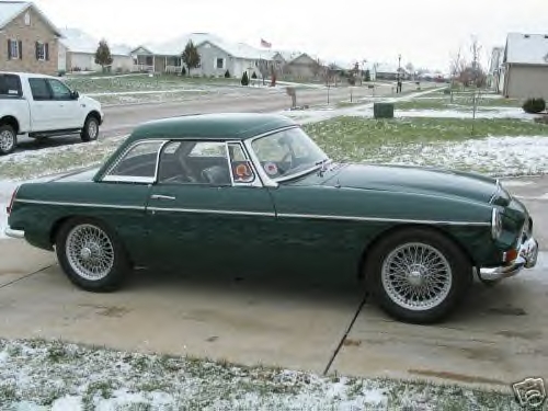

Here's a pic of my '68 MGC with body coloured hardtop. The hardtop on the '69 MGC is white (the bodyshell is red)..but I did paint it the same shade of white as my '78 MGB..so it interchanges nicely.
