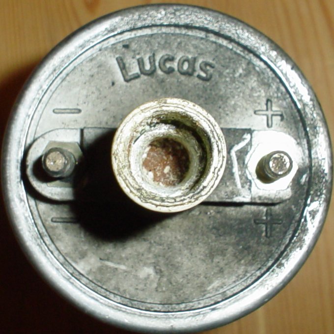

on the other hand, I've had a bad coil (badly corroded terminal) give me the exact same symptoms. Very hard to start after an over night cool down but fired right up every time after the initial. The coil is an easy fix... if yours looks anything like the one in the attachment to this post... change it...
I kinda think we have and we did: "Cold start" to an internal combustion engine is anything under about 100 degrees F. Your descriptions are reinforcing the choke as the MOST likely problem. Your: "...difficult to keep runing when it first starts. Once it warms up, it runs totally normally." is the CLASSIC choke malfunction symptom. Start there.
Well, it ~IS~ easier to pull a coil wire than to yank that choke apart. START with the coil, then /ubbthreads/images/graemlins/wink.gif
