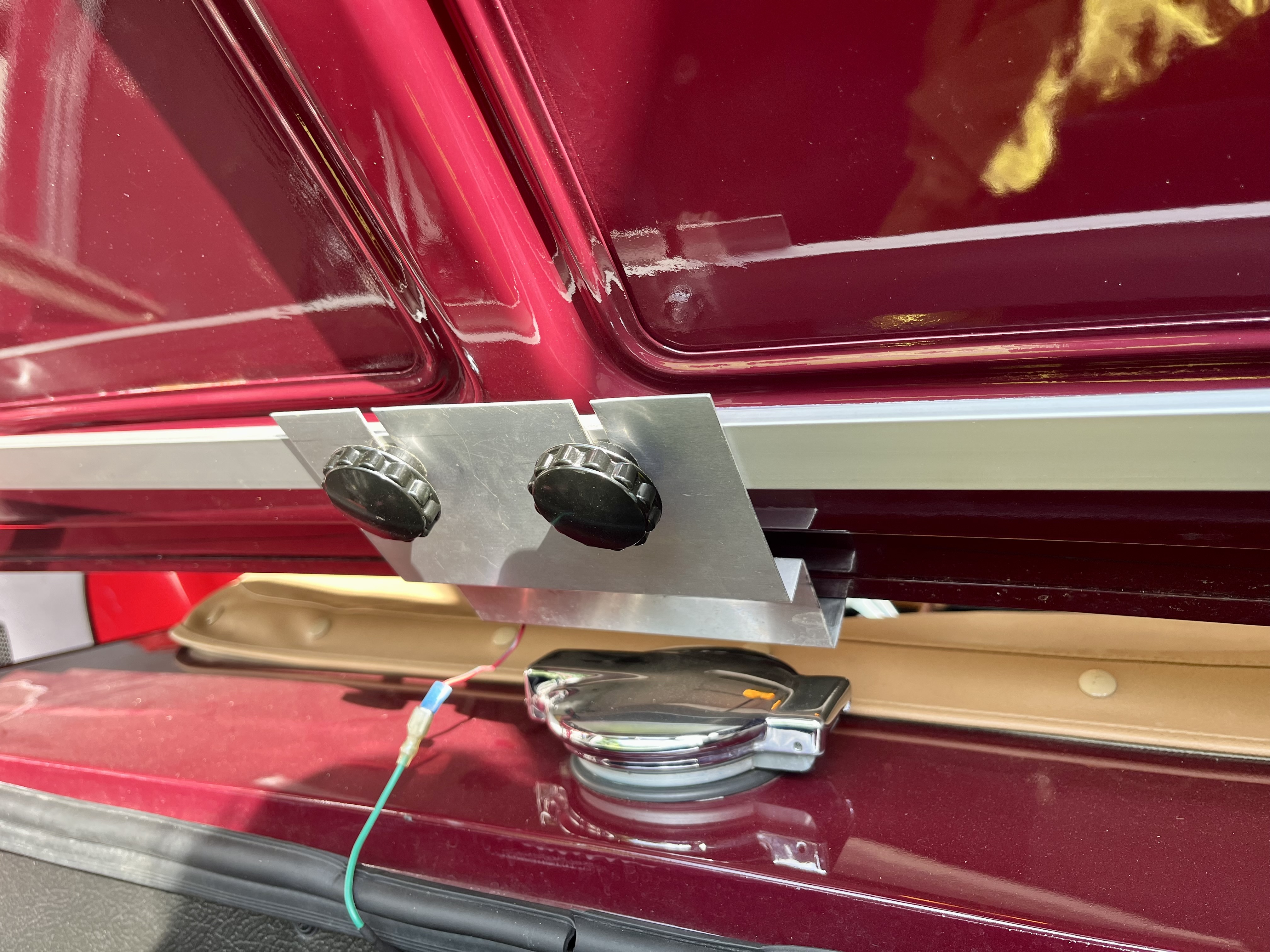

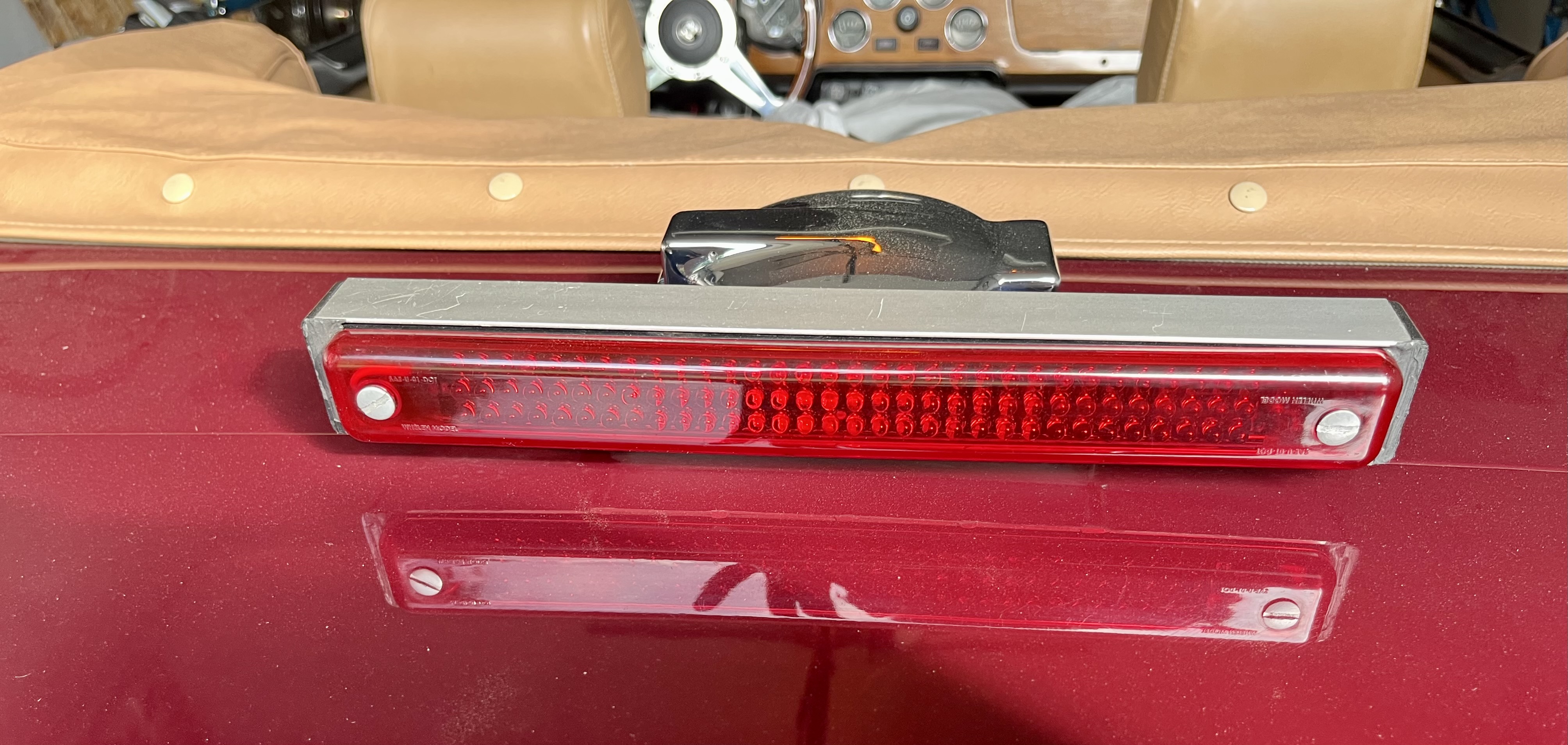

Here’s the one I built. It’s easily removable.

I made mine from an LED strip that came off of a police motorcycle made by Whelen. It’s configured to flash continuously as long as you’re stepping on the brake.

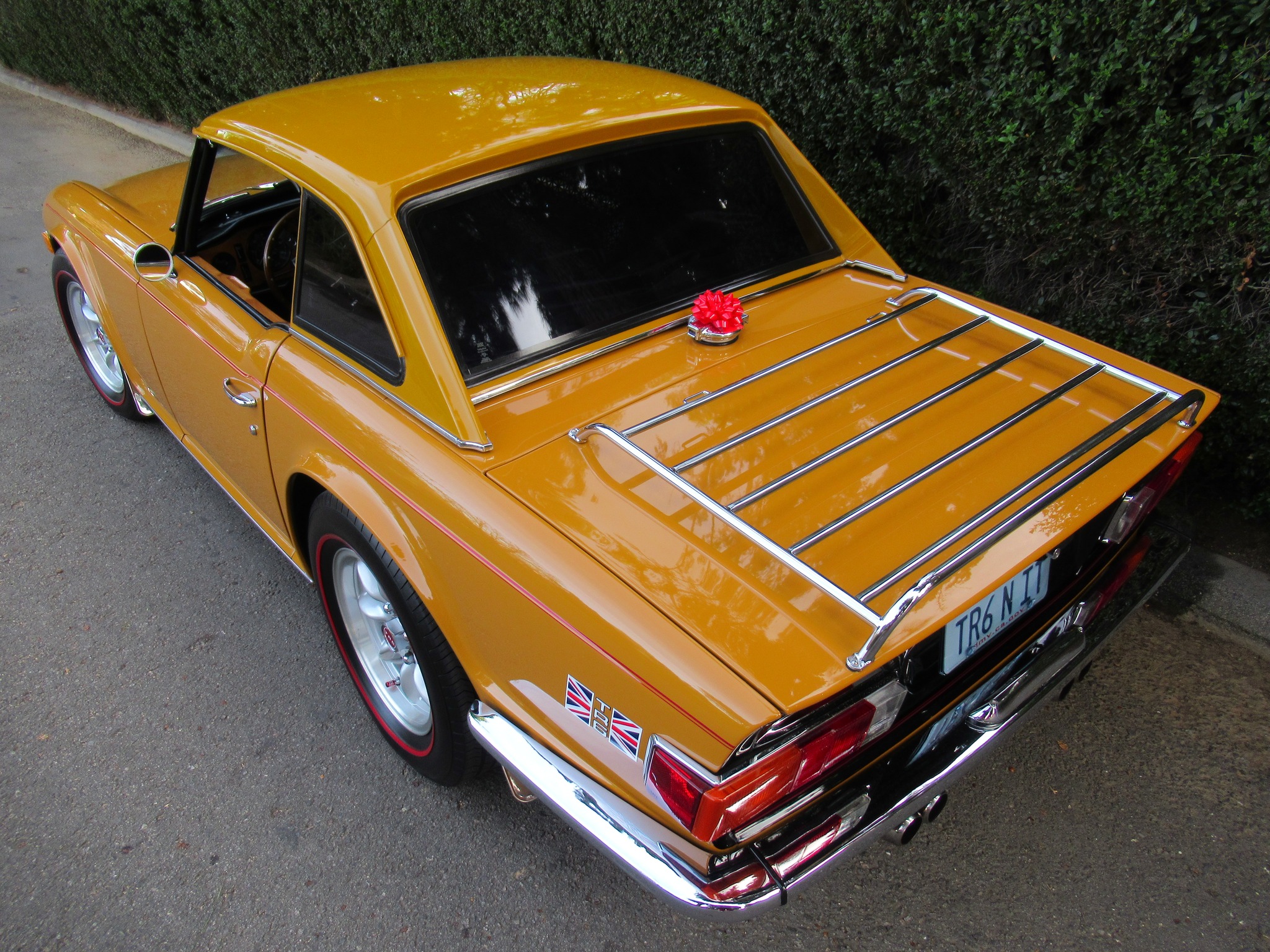

Like the continuous flash idea, currently pump my brakes to alert traffic until rear car is stopped, any 3rd brake light mounted above boot lid level to compensate for the small diameter OEM TR6 lights is a modern day neccessity for LBCs
Here's a video of the light... white light on trunk is reflection of ceiling light and the annoying sound is the door open alarm.
Yes, but Speedway sells a billet housed lamp that( with a little work) can be mounted to the rack
and the wire threaded through the tubing. I have done 5 or six for area 4's /6's .

Although I do have a luggage rack I’ve elected not to install it. My light is quickly removable. Open trunk, loosen the two locking knobs, and unplug the power wire.
This makes it convenient when I take my car to a show.
