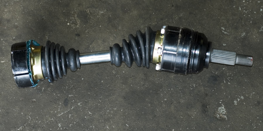

Ok I apologise in advance. I don't have great pictures, I was fixated on taking pics of my tank installation.
I'm missing one of the 3 parts in the image I've attached - the adapter that bolts to the diff - you'll see why when you read the blurb.
Fitting - the next set will be a straight bolt in.
1. Hubs - they were a fraction (less than 1/32") too big at the back to push in easily. We ended up taking off the powdercoating with a sander and used a file to smooth off the inside of the swingarm (literally two minutes work). It all fitted nicely then. I'm sure he'll fix it for the next set - I already sent him feedback.
2. CV joint. You'll need to drop the spring and jack up the swingarm to get enough room to get it in - it's a tight squeeze due to the length of it. It's very snug too in the cylinder through the swingarm - we might end up having to run a cylinder hone through the swingarm, just because it's quicker than sending them back to be turned down - assuming it is even required. Its hard to tell because we couldn't snug it down properly as I screwed up for 3 below.
3. Adapter - Here I messed up. I sent the Goodparts diff straight off to the garage, and I didn't realise that the adapter plate had studs mounted, and not holes like the stock one. There isn't room on the back to put nuts and bolt it up, so I'm having the new adapter welded to the old adapter, again rather than send it back and wait a week or so.

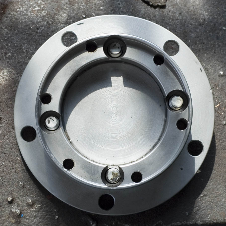

This is the adapter plate for my R200 Goodparts diff with the adapter for the CV axle. You can see how it would be fine for stock.

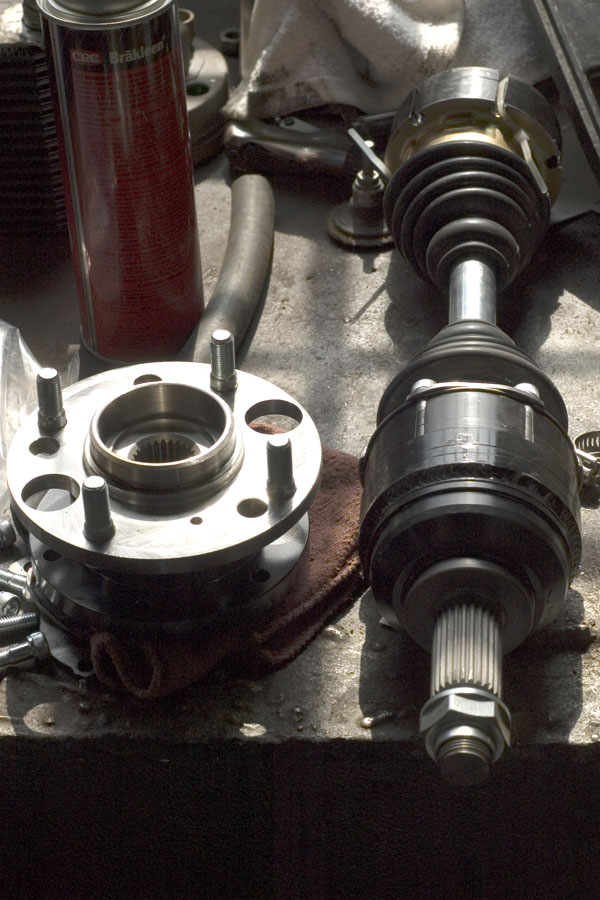

This is the CV joint halfshaft setup. Its been on and off a couple of times - it was a lot cleaner when it came.

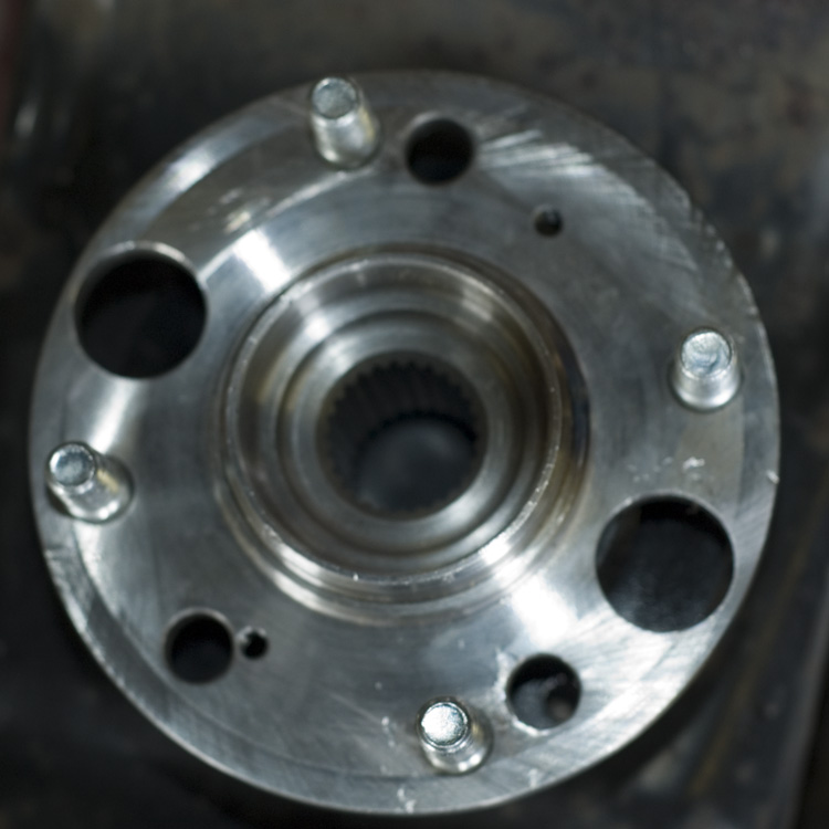

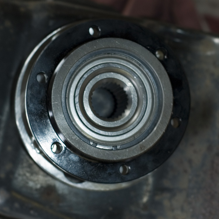

This is the rear of the hub assembly. Bearings and carrier are from an SHO Taurus so will be cheap to change and aroun for a long time.

This is the front

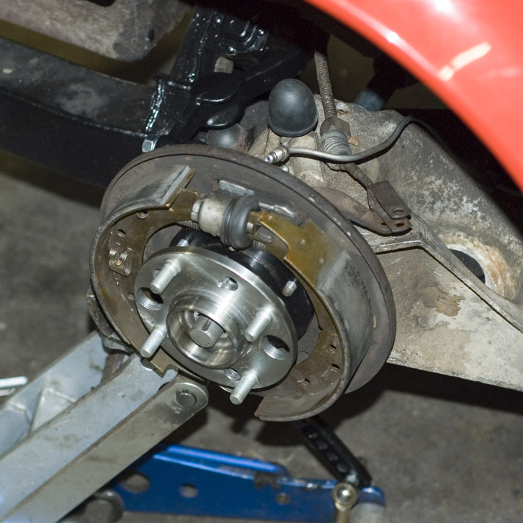

You get an idea of how it looks in the car. This is still test fitting - note no spring...

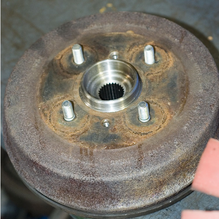

And how it looks with the drum on
