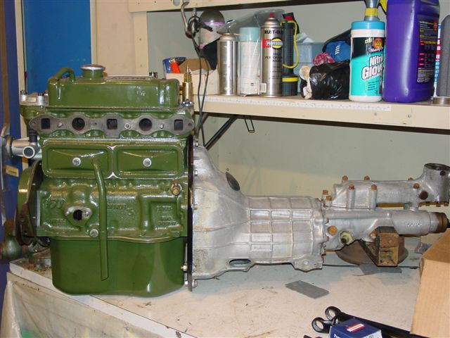

Ok front cover I have not looked at my pictures of my engine during resto in years. Have since changed to the canister type. Heres a good one of the manifold side of the block. There are some numbers down on the right side as was quoted mine is 700 dont know what they are but you can see the cast 950 on the front cast rather large. 1275 and 1098 also I belive had a large "tag" in the same location instead of the cast in digits.
