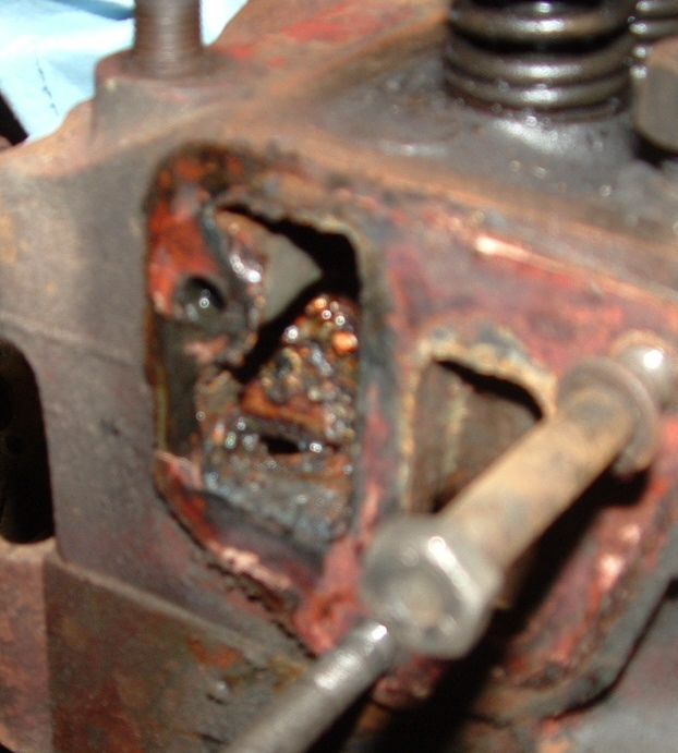

I've pulled the water pump in my ongoing restoration and found that the galley way leading from the pump to the right side of the engine appears to be blocked. I should say the opening seems small to me, but I don't know what to expect so I am asking for advice. The attached pic shows the opening as a dark irregular shaped hole in the galley way. I would poke and prod to see but I've learned to ask before poking.

That looks right. Go ahead and poke a bit to get out any loose junk, and then flush it out with a good stream of water.
