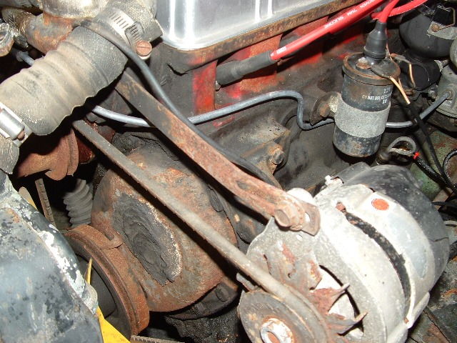

I haven't pulled the cover yet and don't know for sure but this is a glob that only covers about 1/4 of the face of the cover.
Man-oh-Manischevitz is this place the best or what?? I'd have picked away at that schmutz for hours only to find no hole there. Thanks again to all.
I will now upgrade to the next level of membership, and put my savings on a new cover to good use!!

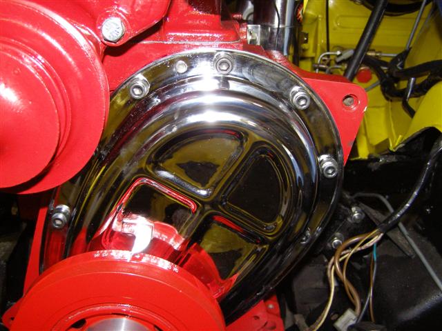

This is what I did with the goop on mine:
